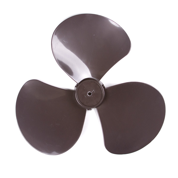

Hi,
Do someone know how to model fan blades in Iventor?

SEE FAN BLADES - DONE IN INVENTOR 2014
1) TRACED THE PHOTO IN AUTOCAD TO USE AS SKETCH IN INVENTOR
2) CREATE BOTTOM EDGE 2-D SKETCH IN INVETOR
3) OFFSET WORKPLANE AND CREATE TOP EDGE 2-D SKETCH
4) CREATED 2 3-D HELICAL SKETCHES USING HEIGHT AND PITCH (PITCH = HEIGHT * 360 / SINGLE_BLADE_SWEEP_ANGLE)
5) LOFT SURFACE FROM BOTTOM 3-D HELICAL SKETCH TO TOP 3-D HELICAL SKETCH
6) EXTRUDE SURFACE OUTLINE SKETCH OF SINGLE BLADE
7) SPLIT (5)-SURFACE USING (6)-SURFACE AS SPLIT TOOL
8) TRIM FACE BY DELETING FACES THAT ARE OBSOLETE
9) THICKEN SURFACE THAT IS LEFT
10) ARRAY SOLID
11) CREATE HUB BY REVOLVE

Hi Neznajut,
In a few minutes I made the following.
Using the command "Loft".
1e draw a route with several planes. (2 ore more)
On each plane the particular shape in a sketch on the plane.
Use command Loft to run in one shape from 1 sketch thru all to the last.
after that use the command circular Pattern in a assembly to make and run these 3 blades around an axle.
See further help at youtube "loft" and later "Pattern".
Or tell me the next problem you struggle or deal with.
Best Regards Tommy
