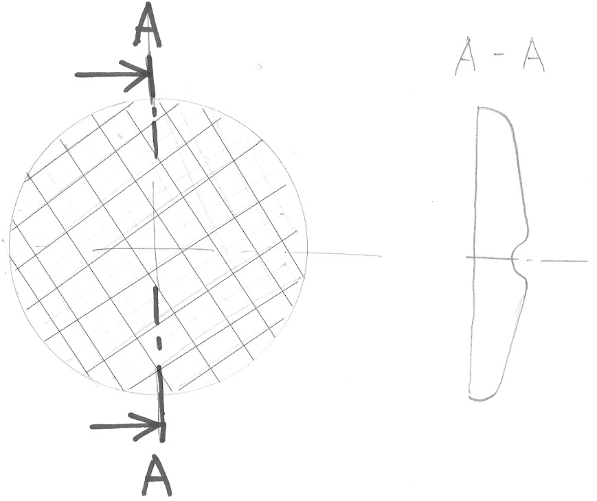

I have a problem with fan cover. I just do not know how to do it.
Ofcourse, I can do it wire by wire, but i want more faster way.
Task
http://s11.postimage.org/xbv6khy03/Untitled.jpg
I did it.
Fan cover

Have a look at http://grabcad.com/library/fan-grill--1
This is a generated by drawing a surface onto which a number of 3D curves are projected. A circular profile is then swept along each curve.
Its rough and ready but gives a possible solution
"...revolve it"

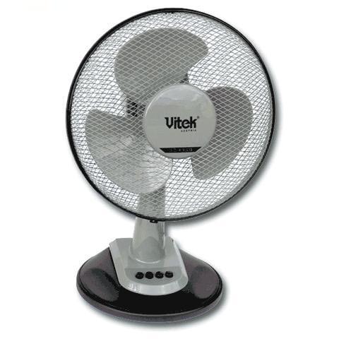

It is solution for wires modeling like fishnet. Please, look at http://s11.postimage.org/xbv6khy03/Untitled.jpg
and
http://irecommend.ru/sites/default/files/product-images/25544/vitek_breeze.jpg
