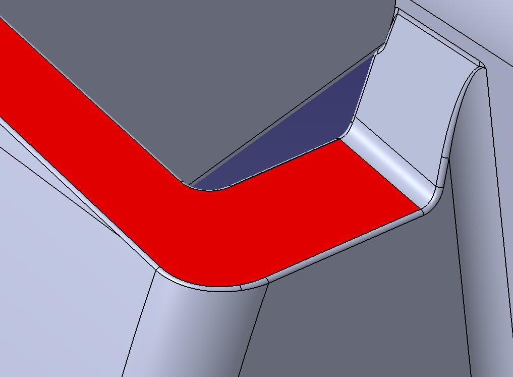

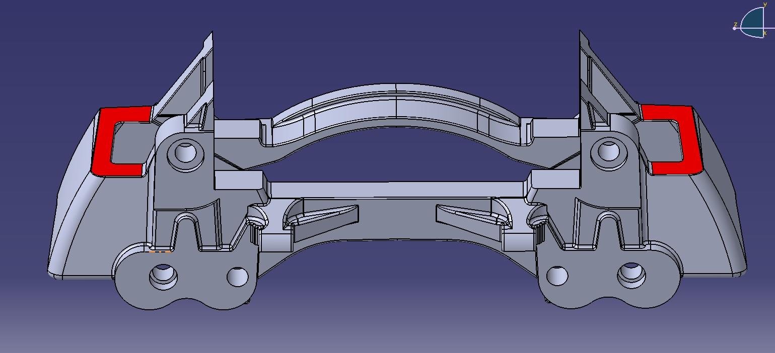

I want to machining the surfaces that are red in the part by 2 mm, but because it has fillets on the edges of the part, this cannot be done with the Thickness command in catia. please help me for do this

There are so many ways you could do this. One way is to Deactivate the Fillets so you can do the Thickness.
is it a flat surface?if it is, make a pocket
