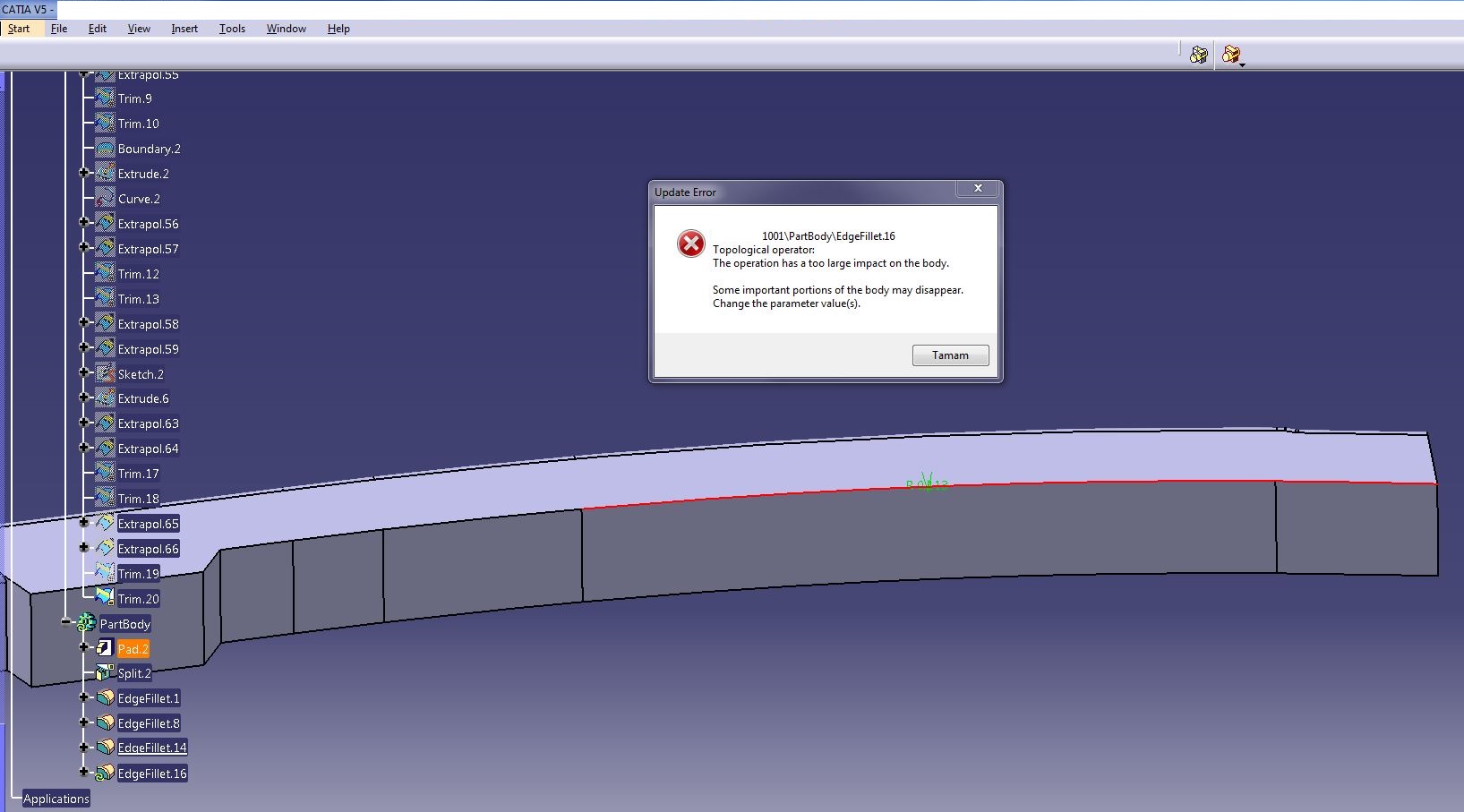

edge fillet problem
hi guys,
i wanna make a fillet this surface but catia give a error someone can help me?

i need fillet 0.117in but the program gives errror. it is allowed 0.2in. i tried decrease of value but it gives again error. also i tried edges to keep section but it doesn't work. do you now any other solutions?

The fillet is struggling with the sharp edge it hits midway along the part. If it were tangential, it'd be fine. If you added a limit, it'd be fine.

reduce the value of fillet and try.
Your fillet radius is probably too high. you should try reducing it and try again.
Another possible cause is that you are using only a part of the edge, and not it it's complete lenght. So it might not be able to keep that edge for the radius you want. In this case, you can try select the edges you want to keep with by clicking more>edges to keep. another possibility is spliting the body in the limit where the fillet will be applied, apply the fillet and join the two bodies.
Reduce the radius of the fillet. If the radius is fine then, there are sharp vertical edges in the path of fillet. Eliminate vertical sharp edges and make smooth edge line for filleting.
