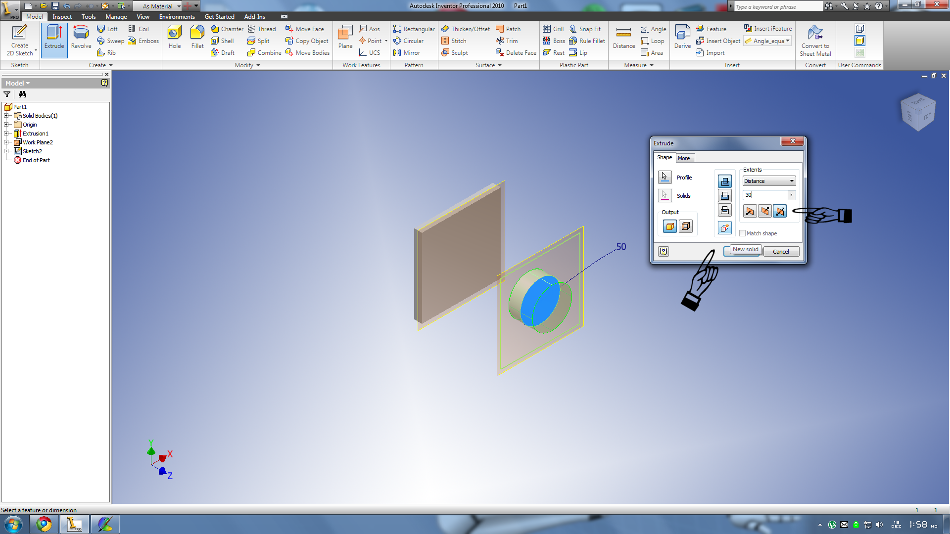

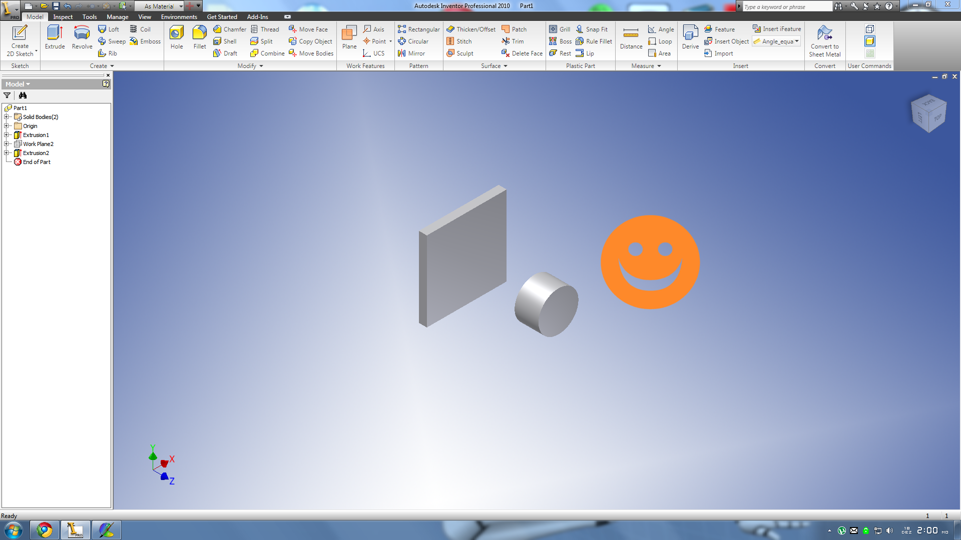

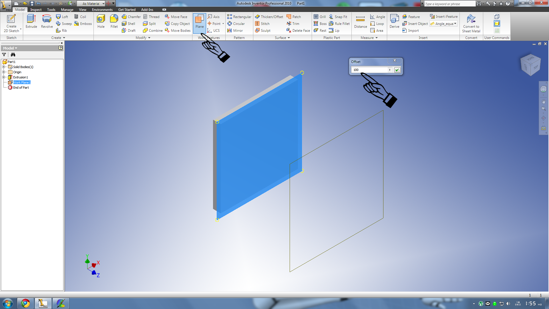

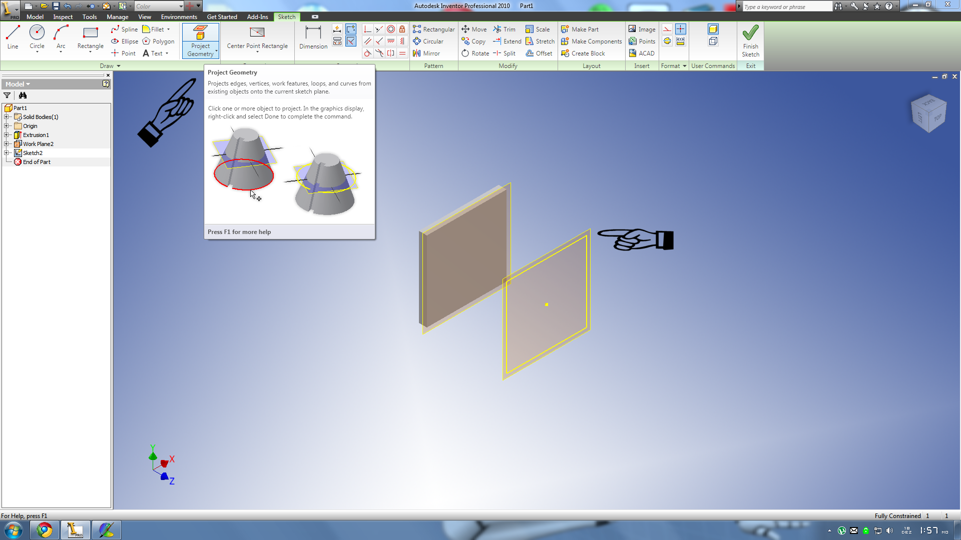

Not to sure what you need, but this is what I think :- make new plane on the surface you what to offset then drag this plane to the required distance, then sketch on new plane and then project the geometry required or create new then extrude the amount required.if this is not what you want the post the part In solidworks and I will get back to you.
