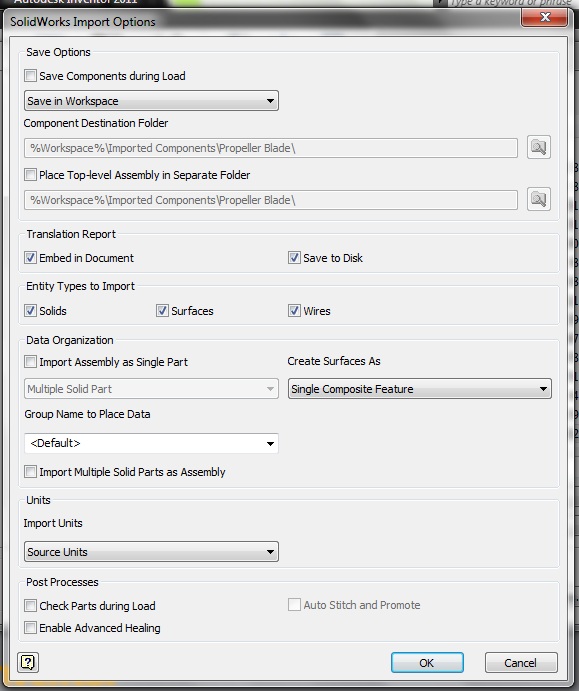

Nick, i tried w/option set the same as but still have problem can not open it (translation report/ status= error)
But i m luck w/ your STEP file. Thank you!

I'm not sure why you can't open it, it opens fine for my using Inventor 2011. What are your settings set to when you click on the options button before trying to open the solid works file? I've attached a screen shot of my settings if that helps. I've also saved it as a STEP file, try opening that one and see if you have any luck with that.
Regards,
Nick.
