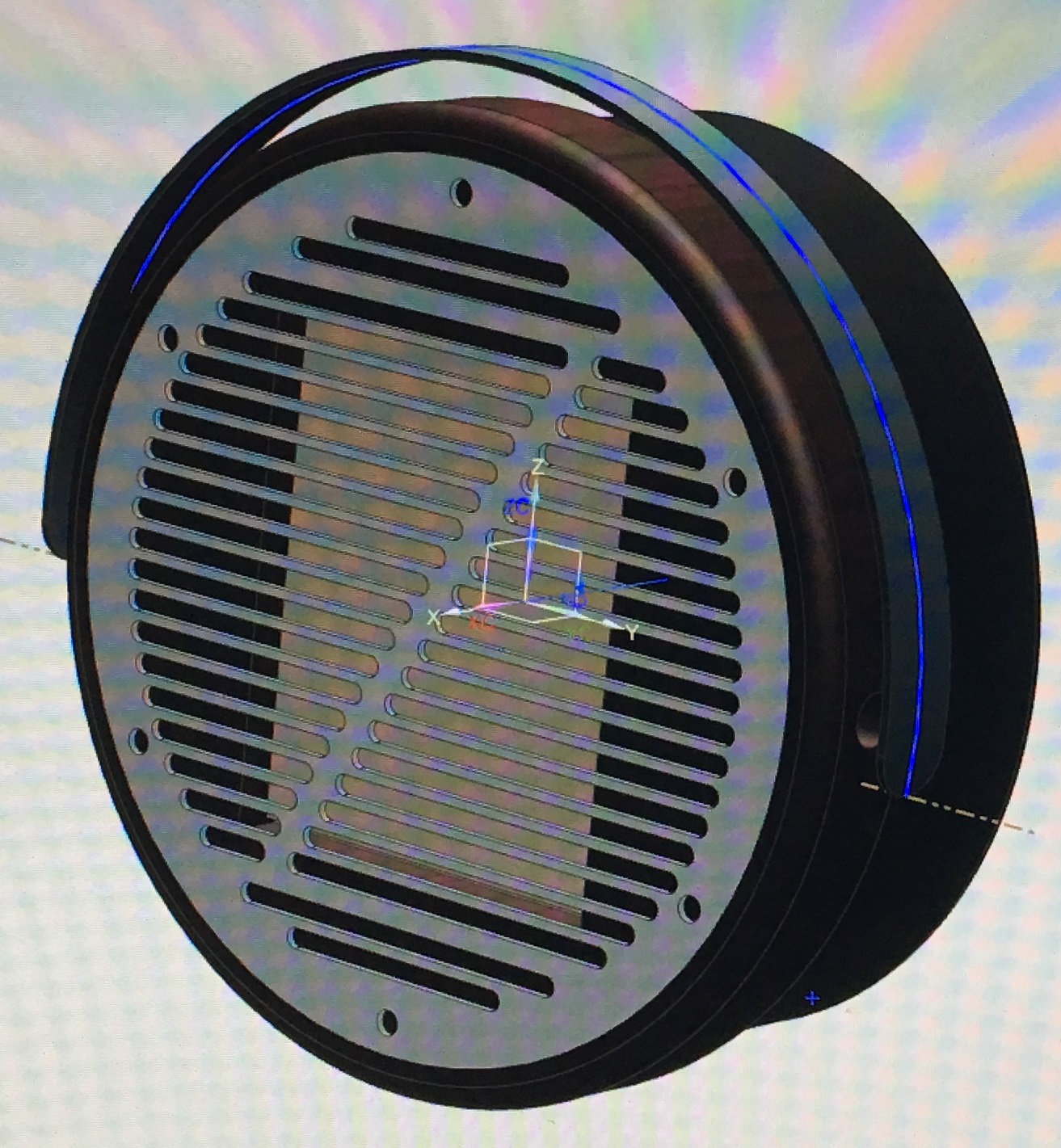

I've done the metinoned cuts (please see the attachment) in NX11 but each profile was manually snapped to both circle and the line. It was a real pain. Now i need to model the same cuts in CATIA. Is there any proper way to perfrom it bby arrays and snaps? One more thing that the diameter of the circle and the anle of the line may change.

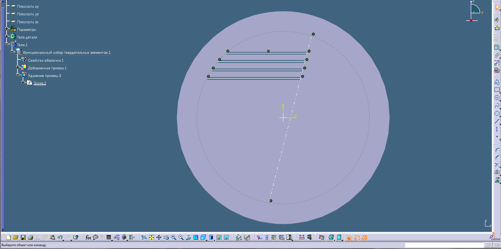

I'd like to improve a little bith the method by using User defined feature or power copy. For that case how should i specify the condition of auto coincidence of horizontal lines (in the pattern) to the circle and angular line (please refer the the picture attached). What i want to do is to add parameters of the quatity of lines, the distance between the lines and to specify it in the pattern.
That is exactly what i need. Thank you özgür!
