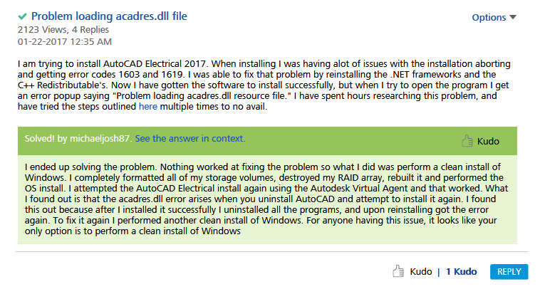

How to resolve the problem of loading acadres.dll file in AutoCAD 2017?
I'm unable to open AutoCAD 2017 Student version in my laptop. It is clearly denying to open it and just says that "Problem loading acadres.dll resource file".
