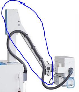

In this link https://www.indiamart.com/proddetail/portable-x-ray-machine-20187560697.html
and also in the attached file
you'll see an Xray machine connecting rod,

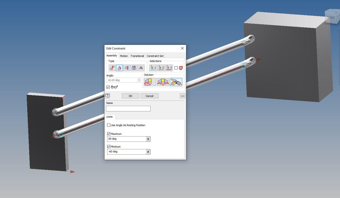

what I want to do is to make a connection between that long rod that can move 120degrees and that rod's endpoints that are attached to it and restrict its motion.
How can this be done in Autodesk Inventor?

I think what you need is a regular angle constrain but add Minimum and Maximum limits to enable the range of motion that you are after.
