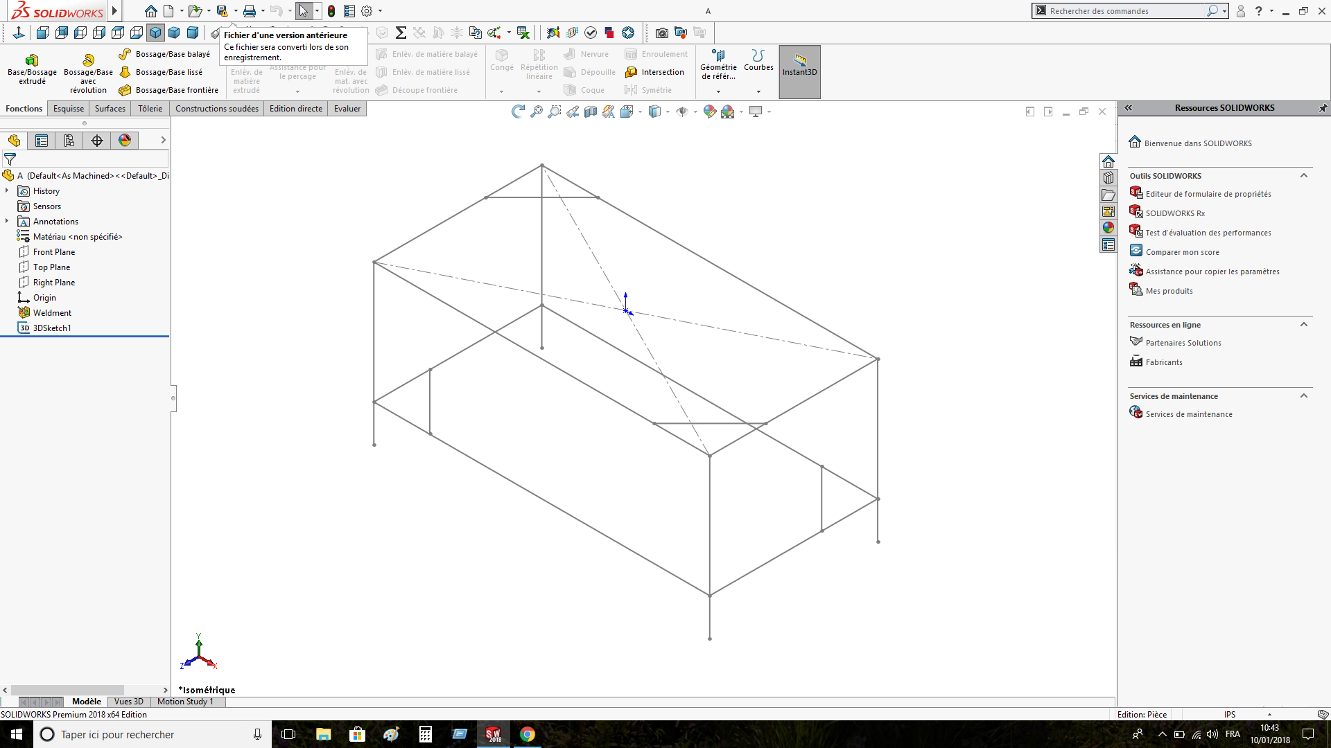

i have solidworks 2018 , and i created a part that containing only sketch , ( image attached )
my question is how can i save this part for old version users , i've tried : parasolid x_t , step , and iges extention but it doesn't work
Can you help me , ?
Note : i want that sketch can be opened in old versions

Iges might be a good option, but press the "options" button when saving the file. There are additional settings you can enable when creating the file. I doubt one of them is clearly called "save sketches" or anything easy, but there might be an option to export curves which you could explore.
I don't know if it will work, but you might try saving the sketch as a library feature. maybe it will open in an older version? I've never tried to do so.
The sketch is pretty simple . Add a few dimensions, and it might just be easier to redraw it in the other version of SW.
YES it works by saving a 3D sketch in * .iges version 2017. Then open the file iges in 2016 ... (or older version) then convert each curve in a 3d sketch. It is interesting that we can destroy imported curves by removing the constraints of conversions of entities in the 3d sketch.
