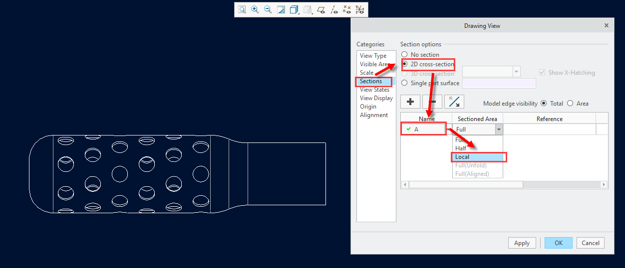

1. Create a section in the model.
2. Select the view on which you want to create the local section.
3. Right Click-> Proprieties (or double click on the view).
4. Go to Sections and select 2D cross-section.
5. Pick your section in the lower window.
6. Pick Local in the Sectioned Area.
7. Pick a point on an edge for the Reference.

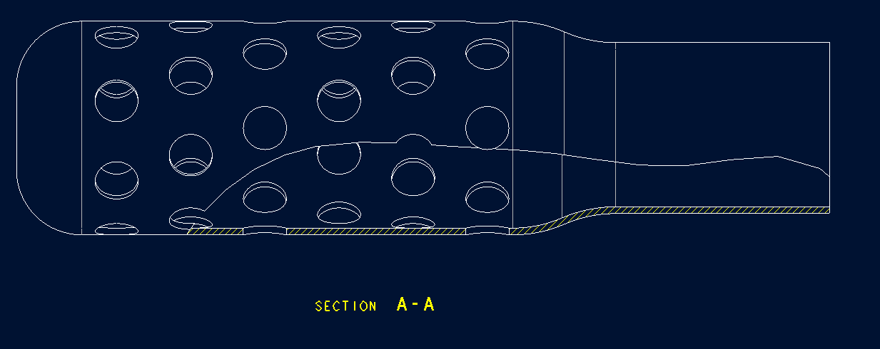

8 Click in the drawing field to define the Boundary (Spline).
9. OK.
