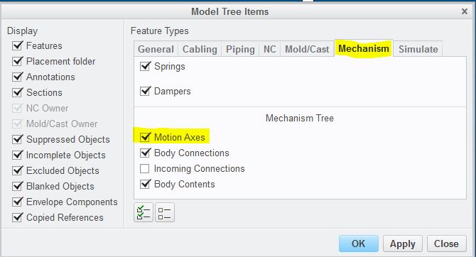

i cant see the motion axis while giving relation in gears mechanism in proE. and without seeing motion axis i cant select it.
Hello,
Try to go Settings (its above the model tree) > tree filters. Feature Types go mechanism and turn on the motion axis and toggle on other things if you need.
