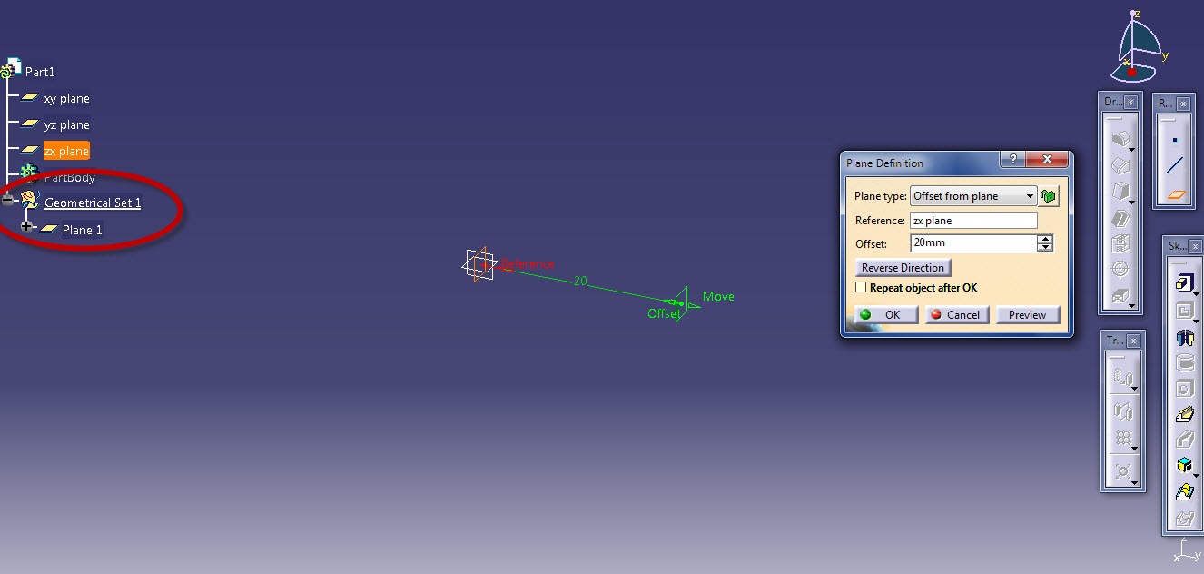

How to stop automatic creation of geometric set in part design?
Whenever offsetting a plane, the plane is created in a new geometric set. How to stop this and create the offset plane in the part body itself?

I you want wireframe in the partbody you have to enable the hybriddesign. Here you can " mix" wireframe and volumes.
Geometrical sets will give your wireframe structure. Many companies do not allow hybriddesign, so you should think twice, if you want to use this modeling strategie.
