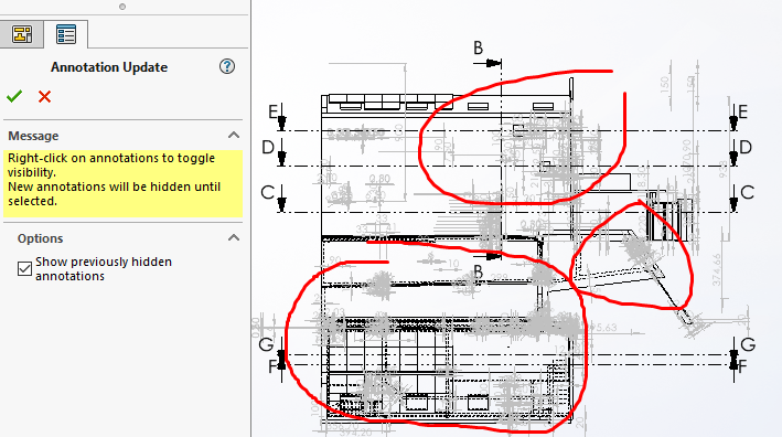

Hello, everytime I open a drawing sheet, solidworks took several minute because it want to display all the dimension from the model.
How can it be disable once for all? Any idea?

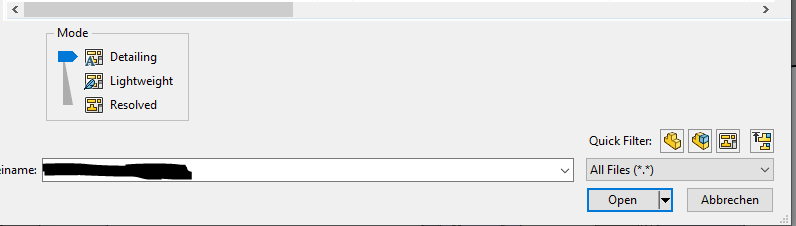

Does it help using "Detailing" option?
2 Other answers
Hi! To stop SOLIDWORKS from loading all model dimensions when opening a drawing sheet:
Go to Tools > Options > System Options > Drawings
Uncheck "Mark all model dimensions for import into drawing"
Also, in the Document Properties > Dimensions, disable automatic view updates if needed.
Additionally, use detached drawings or lightweight mode for faster loading.
