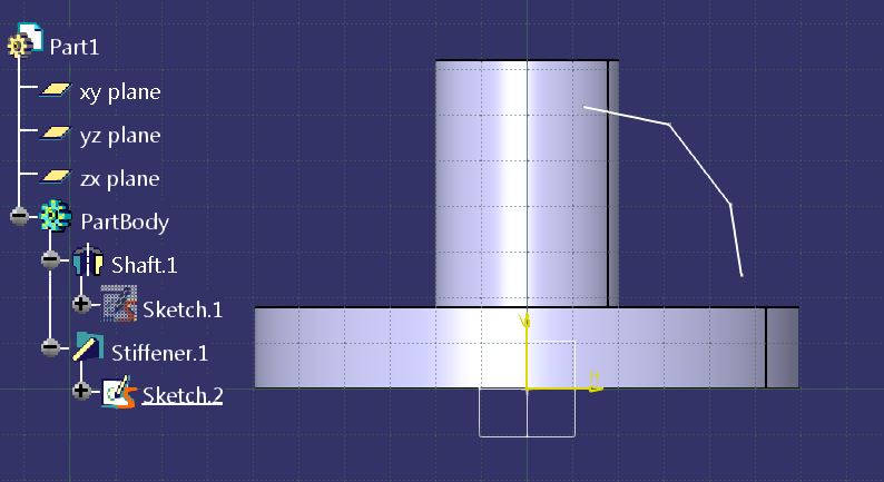

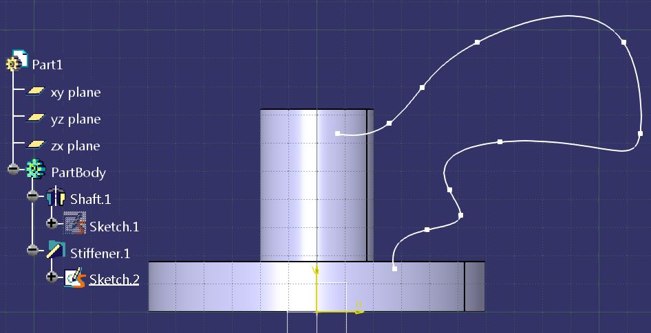

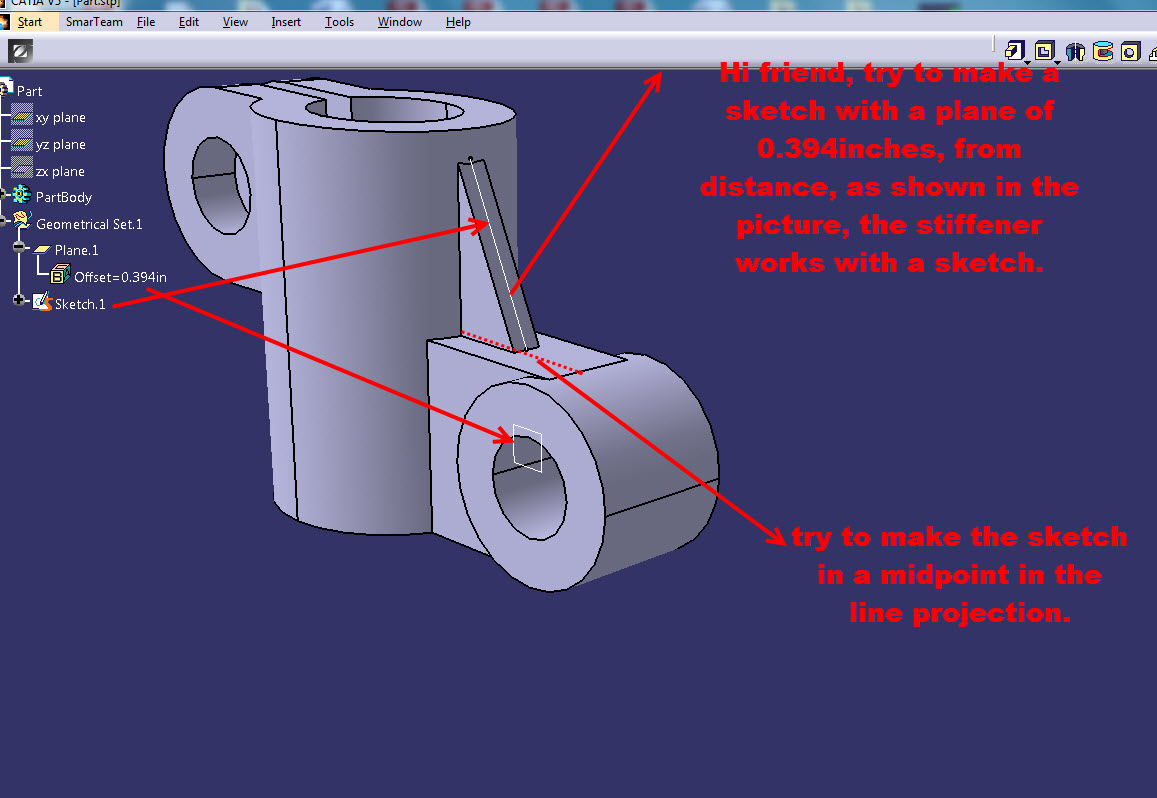

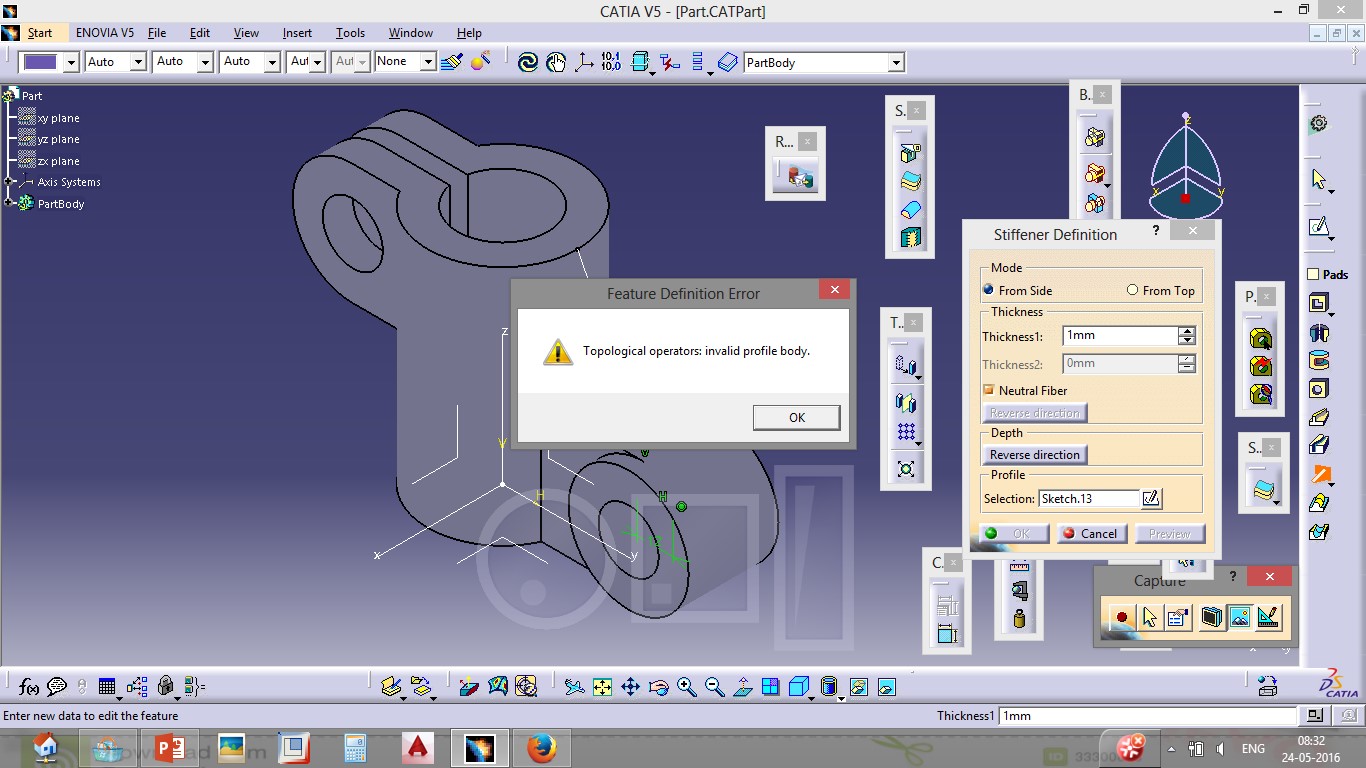

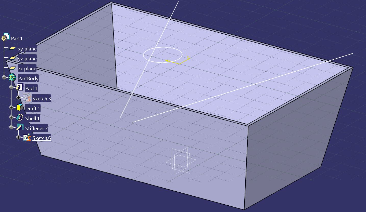

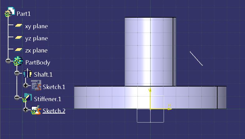

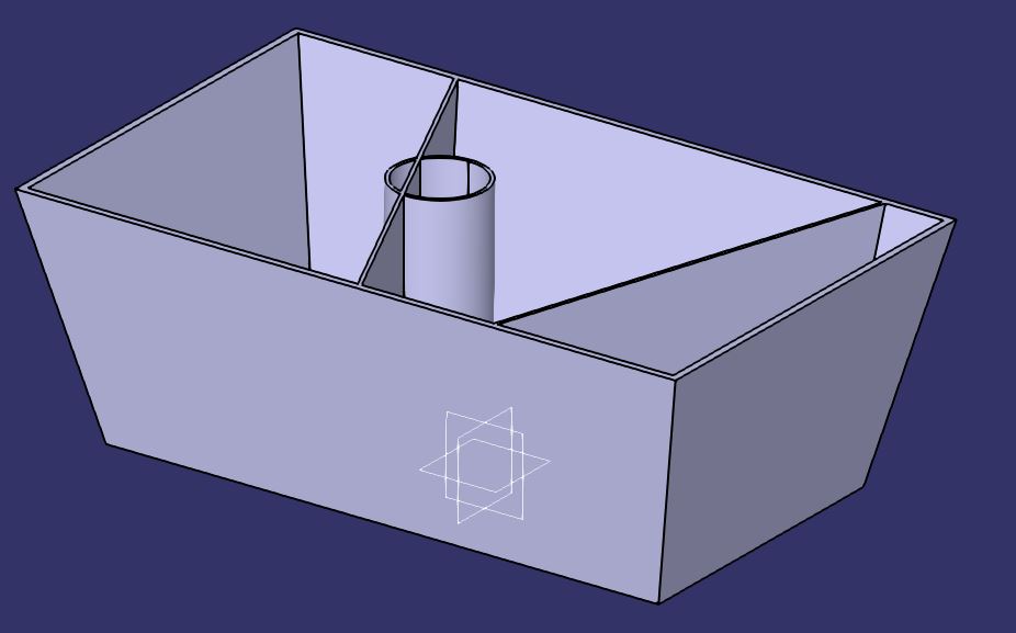

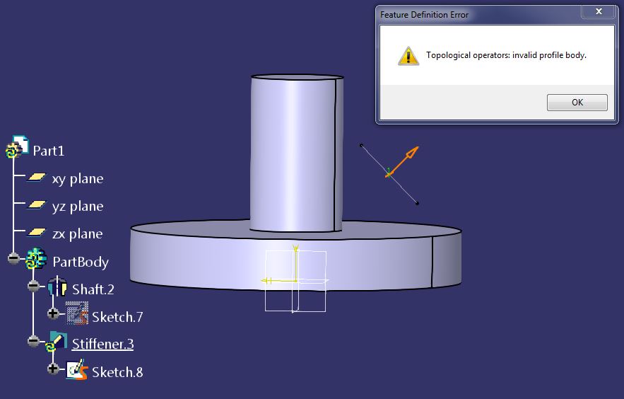

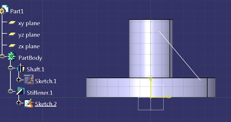

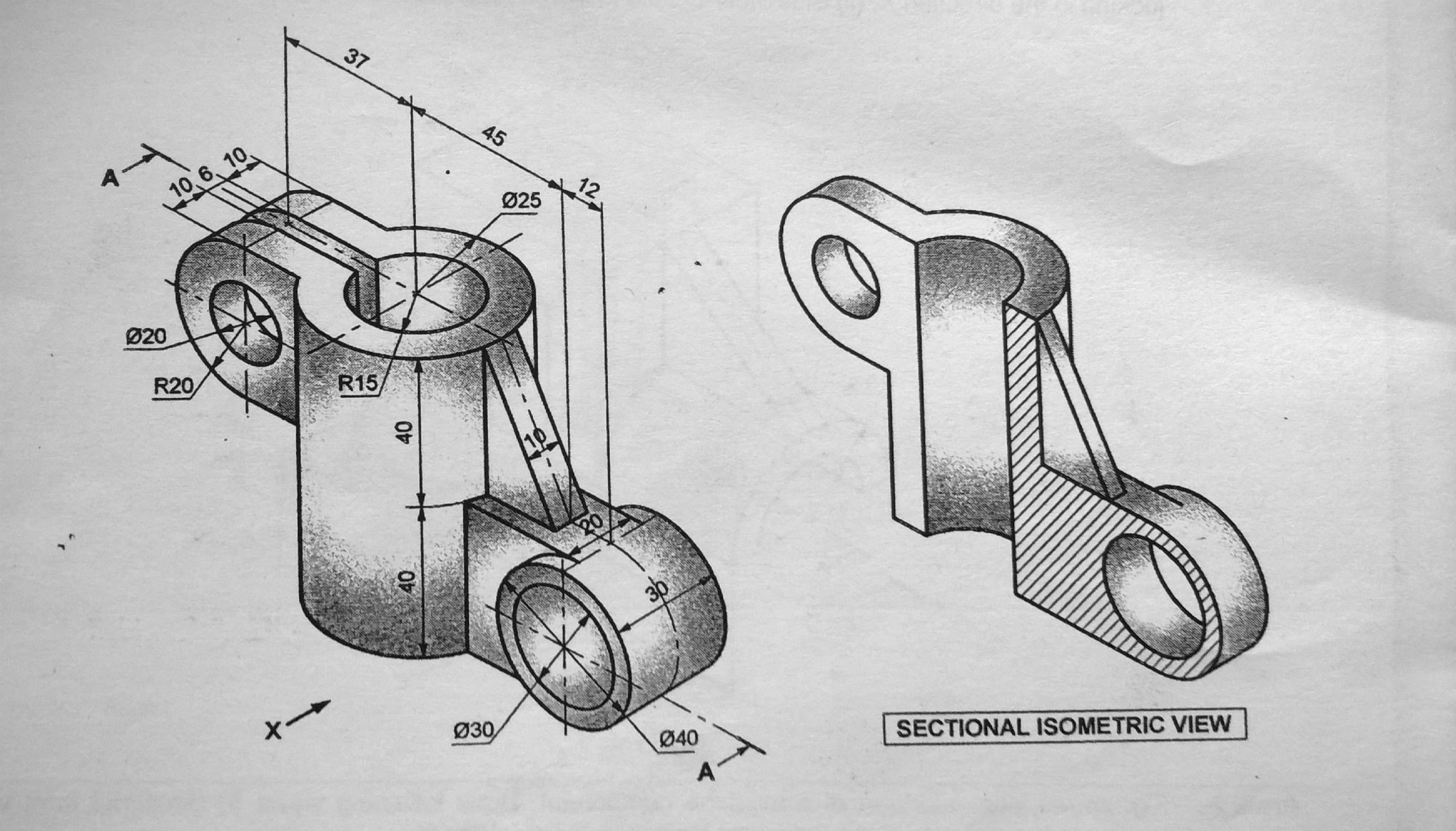

how to use stiffener command in catia v5 dhananjay rehere 24 May, 2016 03:26 AM when i want to create wedge the tropological problem shows 20160524083537.jpg stiffener problem .jpg Part.stp 9 Answer Hugo Alanis Answered on 24 May, 2016 03:05 PM Hi friend, good morning, I am attaching a picture, with some tips. try to make it, and let me know if you have problems. CATIA TIPS.jpg martin Becker Answered on 17 Sep, 2016 01:25 PM To define some ways a stiffener: from Side from Top When You get the Topologicat operation Error: Select the arrow or the Button "Reverse direction" Stiffener_Error.JPG Stiffener_From_Top_Define02.JPG Stiffener_From_Top_Define01.JPG Stiffener_From_Top.JPG Stiffener_define04.JPG Stiffener_define03.JPG Stiffener_define02.JPG Stiffener_define01.JPG Stiffener_From_Side.JPG Hugo Alanis Answered on 24 May, 2016 02:27 PM https://www.youtube.com/watch?v=xFWB2uf3dwI Hugo Alanis Answered on 24 May, 2016 02:28 PM http://catiadoc.free.fr/online/prtug_C2/prtugbt0506.htm Muzammil Patel Answered on 18 Aug, 2016 05:11 PM https://www.youtube.com/watch?v=H8m7jXz3S_4 Hugo Alanis Answered on 24 May, 2016 02:29 PM http://www.catia.com.pl/tutorial/z2/part_design.pdf dhananjay rehere Answered on 25 May, 2016 03:01 AM thanks to all liam shernce Answered on 25 May, 2016 02:09 PM you cant baby ' dhananjay rehere Answered on 9 Jun, 2016 09:15 AM Shakti I have a problem to create stiffener between rectangle & circle I will upload the images to you then you solve this problem
