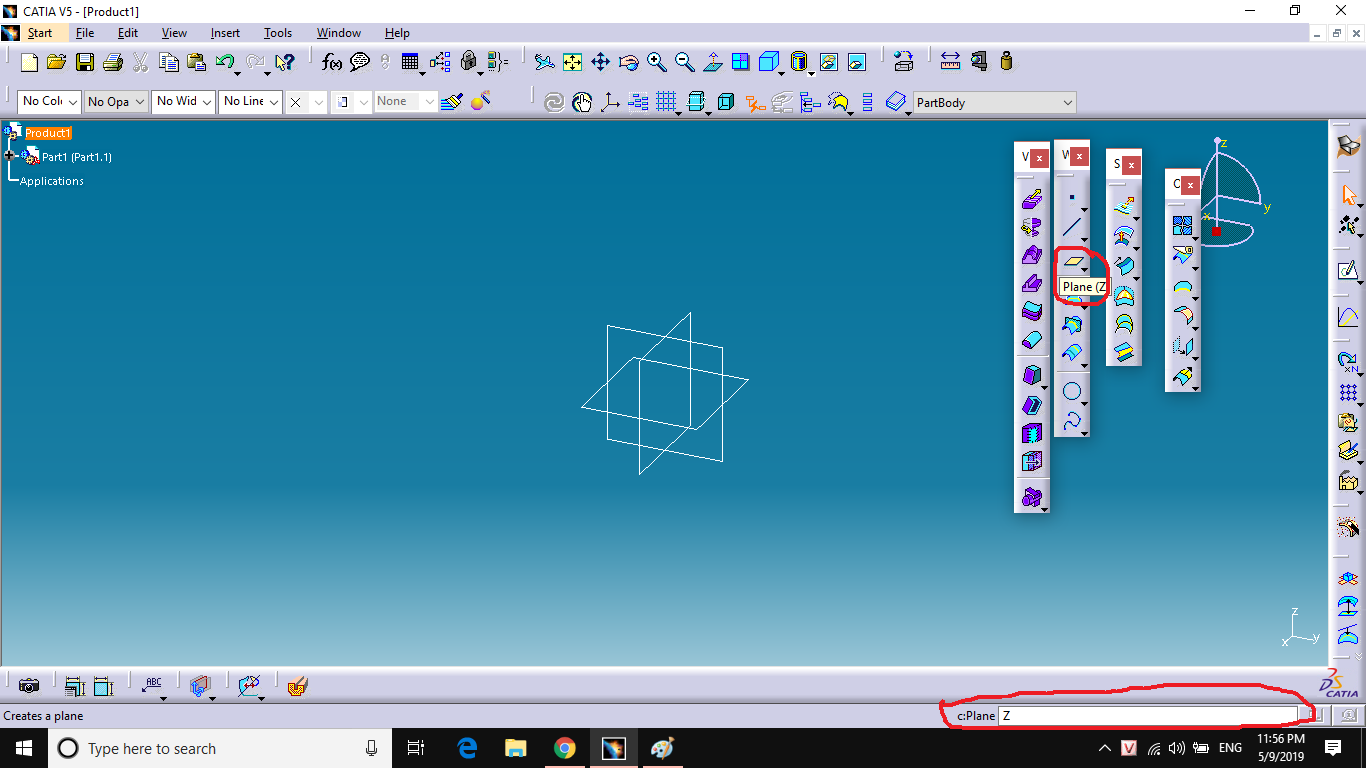

I assigned the letter A for the command to create a plane, but when I did, it showed A on the command dialog below the toolbar. I really want to hide the command dialog. Can you help me?
here's a suggestion to use the P1 platform to eliminate that feature:
Thanks. How to use the P1 mode?
Use Tools + Options, and at the top of the General section you can choose which platform you want to use. P1, P2, or P3. (most people use P2)
