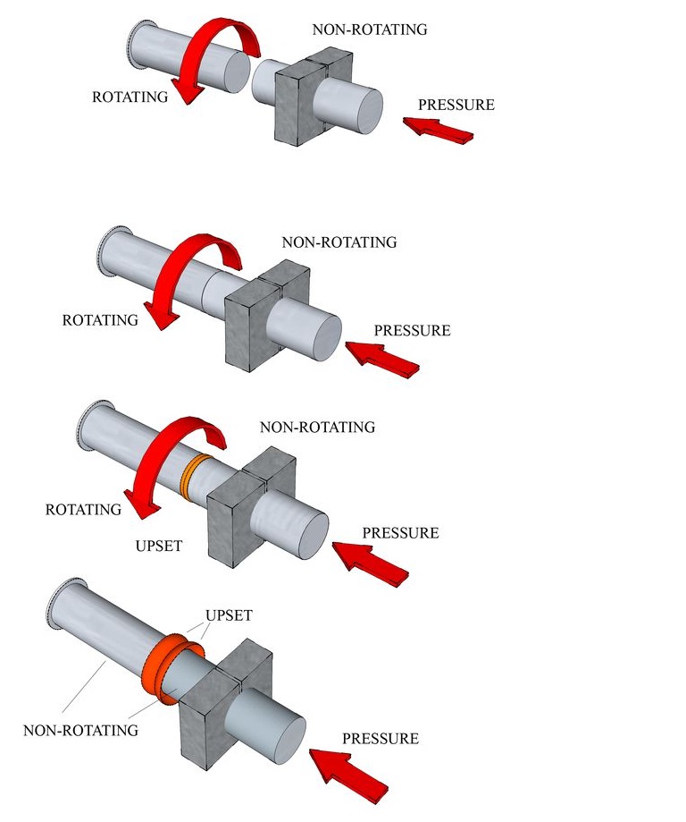

I want to show simulation of rotary friction welding process using either Ansys 14 or pro engineer 5.0
Iam doing experimental analysis on friction welded specimen,static,fatigue,compression,torsion,thermal and microstructure

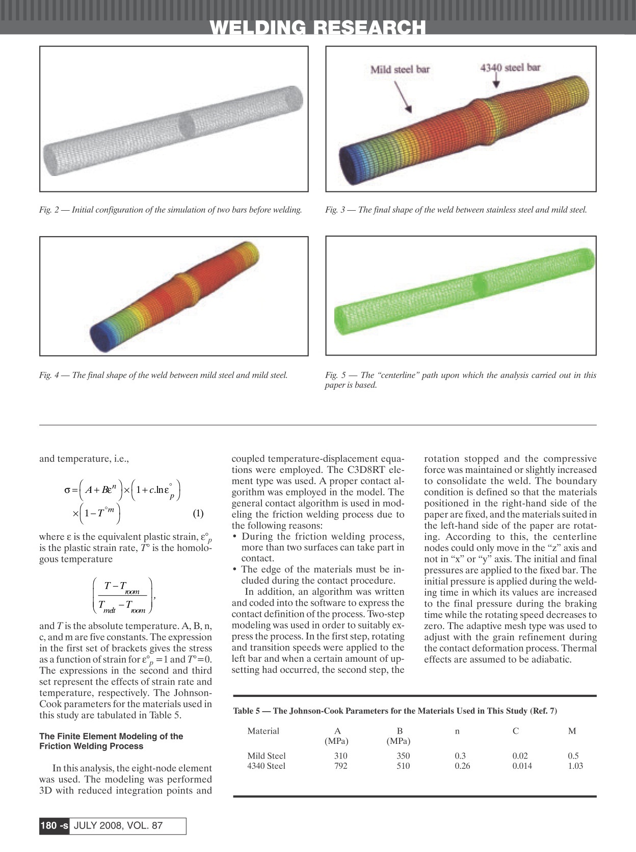

Can anyone help me how to do simulation of friction welding when actually it is happening?????,i actually read a report on this simulation done in abaqus software
