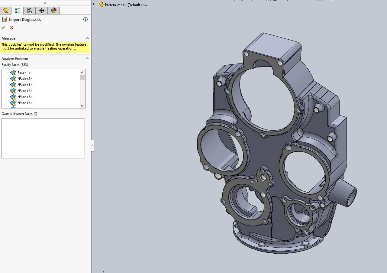

Import Problem ipt file to Solidworks?

I'm trying to Import an ipt file into Solidworks and I get this message. How do I fix this?

The message in my Photo says this body(ies) cannot be modified. The Owning feature must be unlinked to enable healing operations. I don't see that info in your Link.
