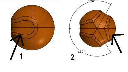

hello freinds i have an imported part which have an impression ( photo labeled 1) which i must to rotate it equally around an axix to get finally the part in the photo labeled 2
who can help me ?
thank you

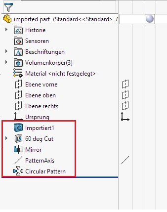

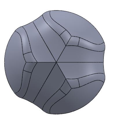

Here is the part you need. I have Solidworks 2016. I am not sure if you can use the file. I have attached the step and the screenshot of the final part and the feature tree.
By the initial look of it, the operations you may need to perform are.:
1. Cut the "Part 1" to get single component of the one shown in Image 2.
2. Then, you have to use the Move/Rotate feature with "Copy" checked and rotate and merge to get the final part.
A STEP or SLDPRT maybe helpful.
Should be able to achieve that with the circular pattern feature. after either doing feature recognition and selecting the feature, or by selected faces. may also need to create a circular sketch around the axis as the pattern path.
