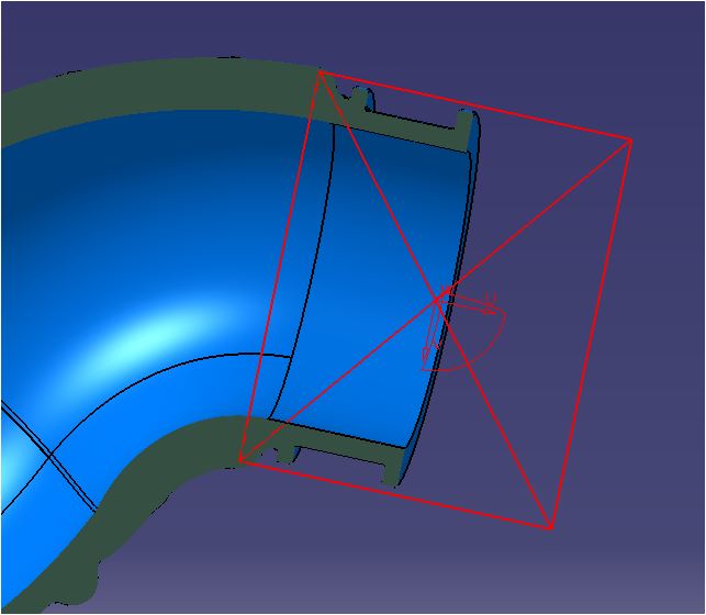

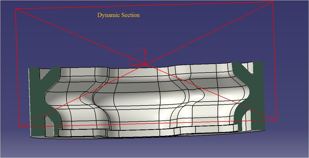

in catia v5r20 want to use measure command while using dynamic section
by using dynamic section i cut the section of the part now i want to use measure command to measure the section thickness and other dim.
attached the snapshot for reference.

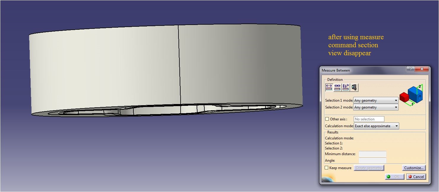

Dear Jack Thanks for your support.
i have already check the option in the setting. bt still not able to use measure command.
as i do dynamic section with a plane to see section the section appear but then as i use measure command to the section the section view disappear and full part appear.
i have attached snapshots for more clarification.
please help and check if there is any other setting
Hi,
This is not possible with the dynamic section tool. You would need a SPA license to perform the action using the assembly based sectioning tool.
Work around would be to create a sketch with intersection projections to get geometry to measure. You could make it dynamic by placing the sketch on a plane controlled by an offset parameter.

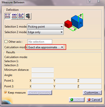

All you need to do is change the Calculation mode to Exact else approximate. As far as I know you can measure in assembly dynamic sectioning. check the attached image for reference.
