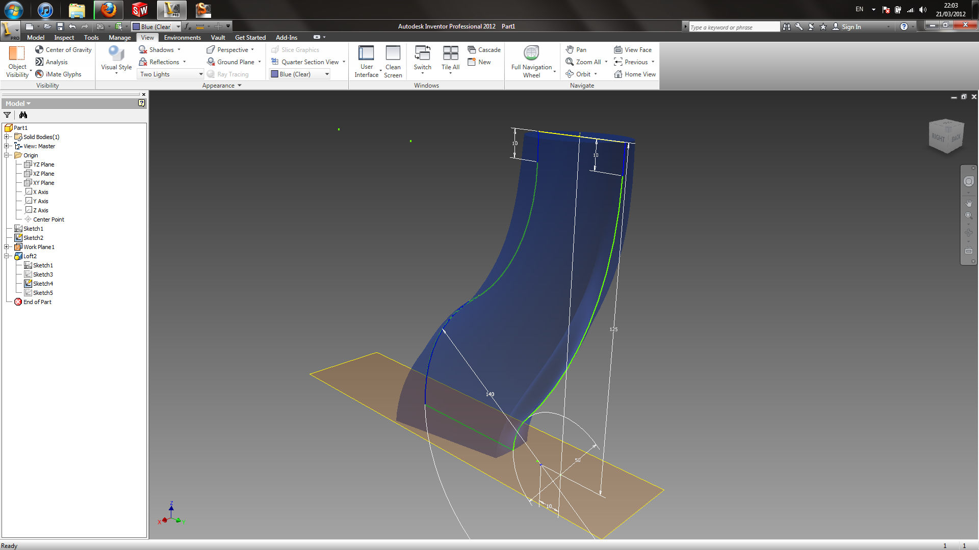

I want to make a solid that starts as a circle and ends like a trapezoid with curved edges (see the image attached). I want the solid to have a specific route as shown in the image, How can I define the imputs in the loft command?

I am not 100% sure I understand this question Manolis
but if I do then I would put another rail in and loft it that way and that will give you the inputs that your require....
That is if I am thinking what I am thinking LoL'ss
Hello Man I downloaded your part no extra rails just a small repair of random overlaping between the existing rails [On a new 2d sketch] and works PERFECT. Find the model in your folder I left free your rails to adjust it.

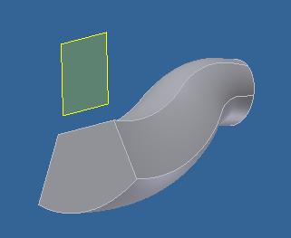

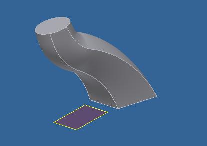

Something like this you want to make? Let me know and i'll extend my explanation
I don't think loft will work for this. Loft is more just a combination of extrude and taper wrapped into one command, its not really for what I think your trying to do here. You might look into some of the "surface" commands like possibly "sculpt", I don't have to much experience with the surface commands but it could be helpfull.

so ..... you are making a hidraulic pump try to use a complete loft with all the section across the volute sometimes works using all the sections , or use the options in loft that says "merge tangent faces"
