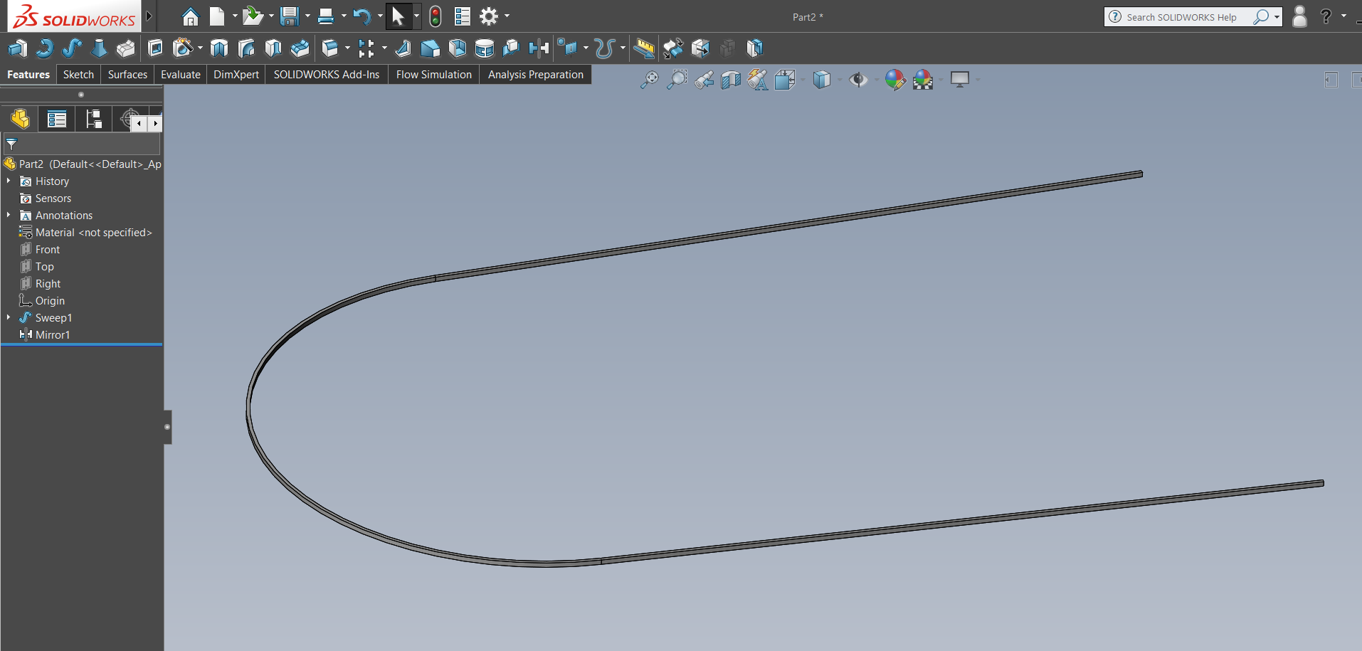

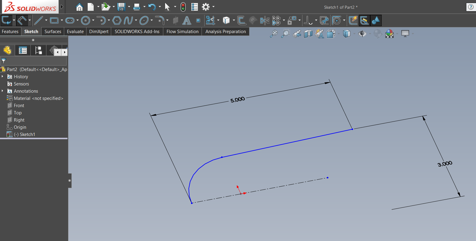

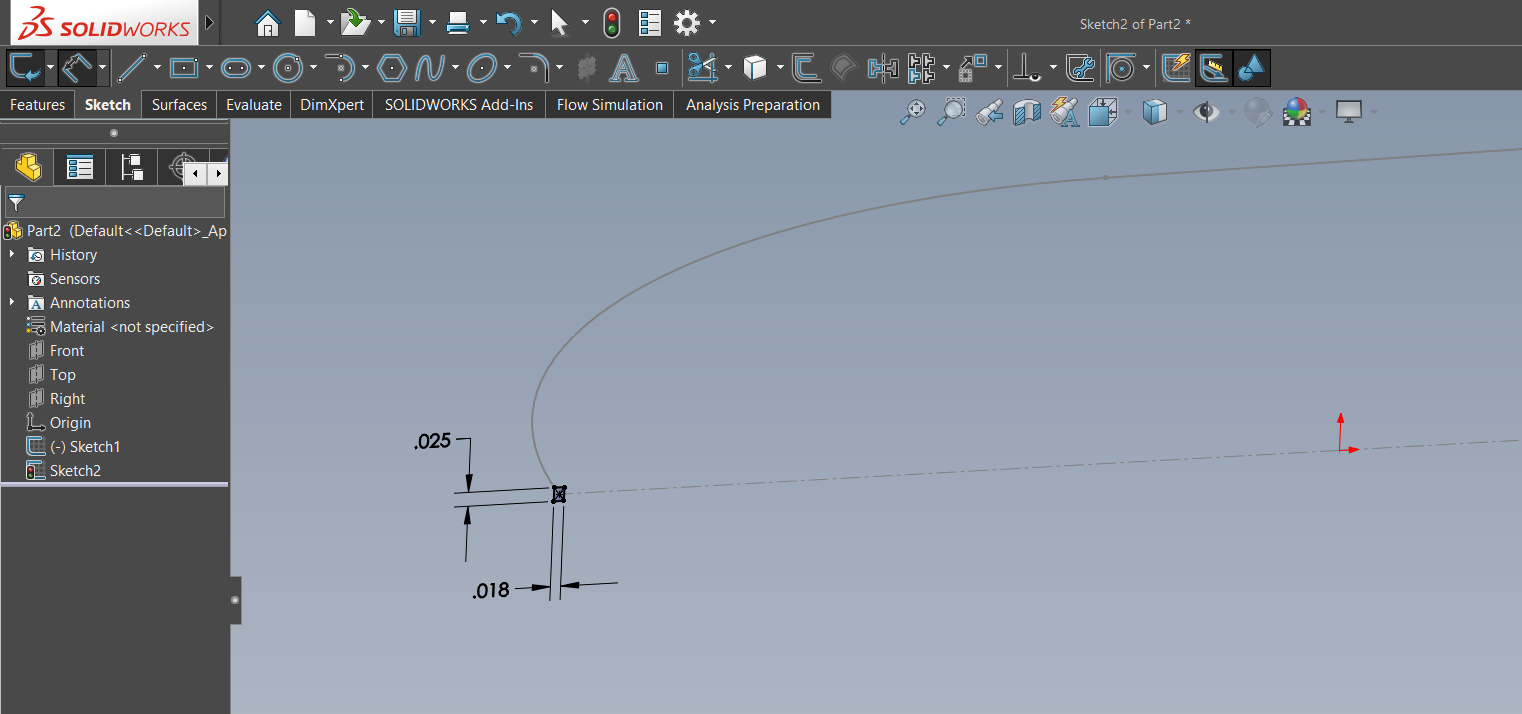

There are a few ways to do it, but the most intuitive is probably a "sweep" or similar feature. A sweep uses a profile (your cross section) and a path (your attachment). The cross section is 'swept' along the path.
I've attached some images to help describe it. Note it could be done in a continuous single sweep, but it's often advantageous to use symmetry and only build half of something that can be mirrored, such as in this example.
