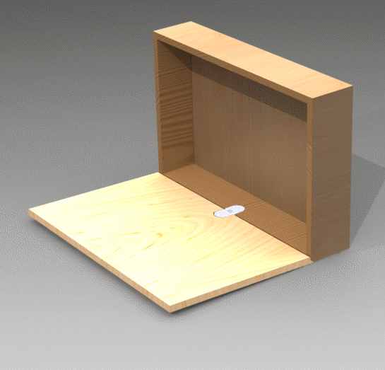

I start with a working hinge assembly with proper limit angles set. Then I mate to the furniture pieces. In my example I made one move using the Rotary Motor in a motion study. The piece with the motor is the door, oscillating the 90 degrees from open to shut. Be sure the rotary motor indicates proper opening action (see screenshot).
