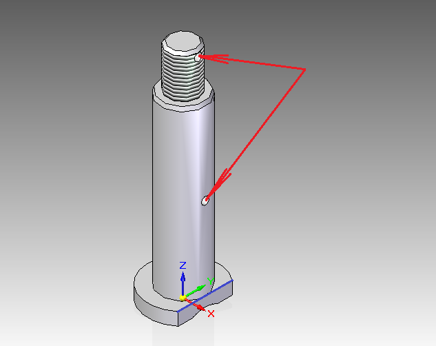

Mating two objects at an angle.
I would like the top part to be rotated 90degrees in relations to the bottom part. The holes should not be aligned with the blue line. How should I do that?
Figured it out. Right click the upper body and choose show/hide component -> Reference planes. Turn on the reference planes for both bodies. now choose Angle from the Relate toolbox and mate using the reference planes. If nothing happens click on one of the bodies in the assembly tree. down left corner you will see the relations. Find the Angle relation and give it the value you want.
