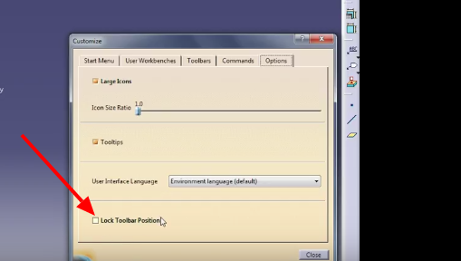

Hi everyone, in my catia enovia, I am not able to see the "measure item icon" in any of the tool bar. I already tried "Restore all contents" & "Restore all position" in customize but not able to get it. But "measure item" is there in customize>>commands>>all commands>>measure item, but when drag it into any of the toolbar, it is not coming. Kindly help me out in this.

It means that tool bar are locked in it's position. To unlock, go to Tools>> Customize>> Option and uncheck lock tool bar position. Later after your arrangement you may lock tool bar position.
