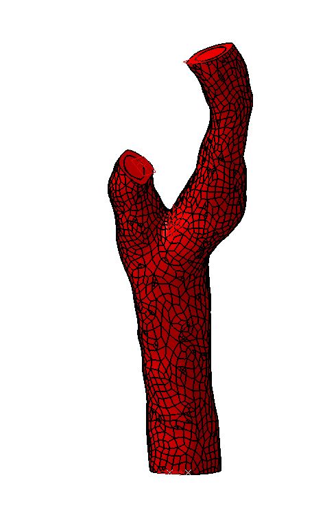

Model in red colour
Why does the model appear in red colour?
2 Answers
Hi Nitesh,
The model seems to have elements, could be pls elaborate in which software you are trying it? and what' ur work so that it is easy explain?
moreover by considering the software mentioned in the question(CATIA) the model will turn into red while modifying the geometrical or dimensional constraints and it needs to updated
and update will be available under edit tab.
It is Red, when there are changes done on it, and is expecting user to press update.
Press ctrl+U.
