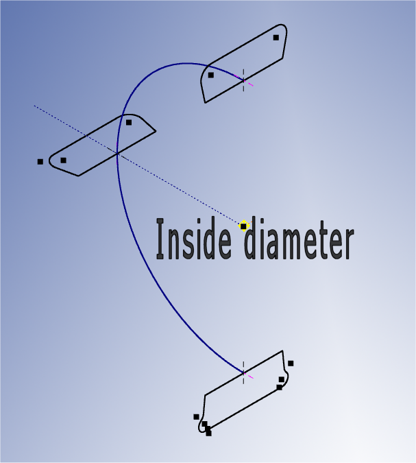

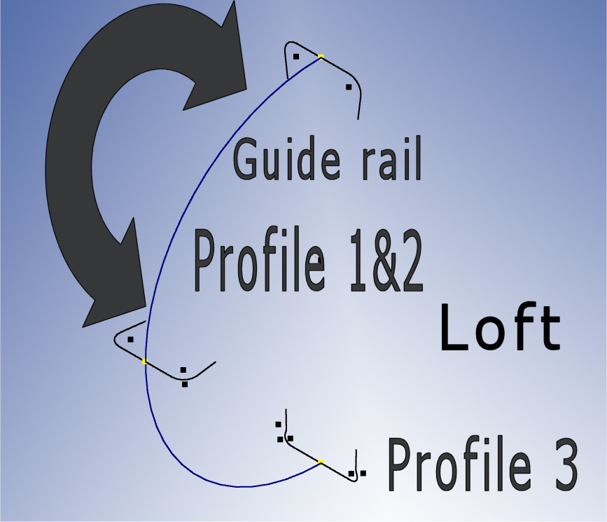

1.Surface loft
2.Mirror
3.Thicken
4.Material & texture
EDIT use inside diameter !!
