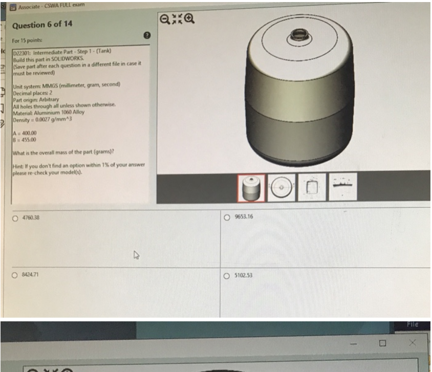

Need help debugging an error in CSWA exam question...

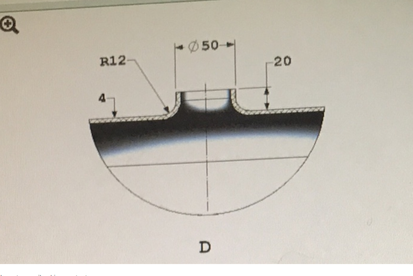

My answer is slightly off but I am not sure why. I was hoping someone could take a quick look and let me know where the mistake is. I have attached screen shots of the question and apparently the answer along with my part file. If someone could take a quick look and let me know what the issue is it would be greatly appreciated!
Accepted answer
Your radius of 200mm goes to the widest point of the container (in the center). It looks like you are supposed to dimension that to the narrowest (virtual sharp) of the container, where the 45mm radius fillets are.
Also, consider using a thin feature for the revolve. No need to offset the sketch. It just makes everything a little easier/cleaner.
