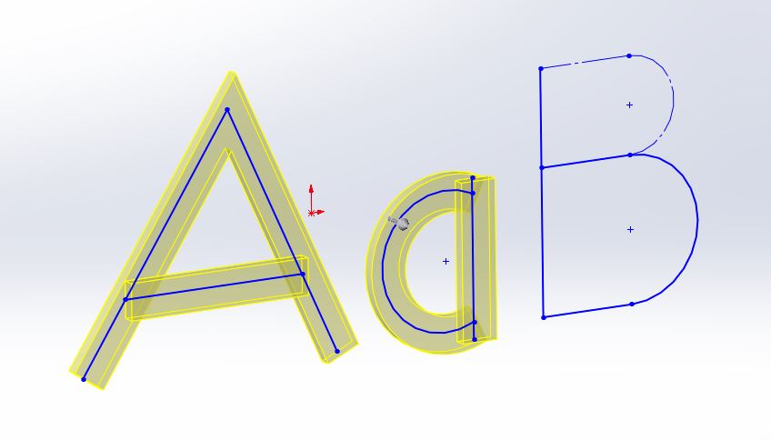

Here's an idea: just sketch the centerlines of the fonts, and add the thickness when you extrude them with the Thin option. Bold fonts would have a larger thickness.
