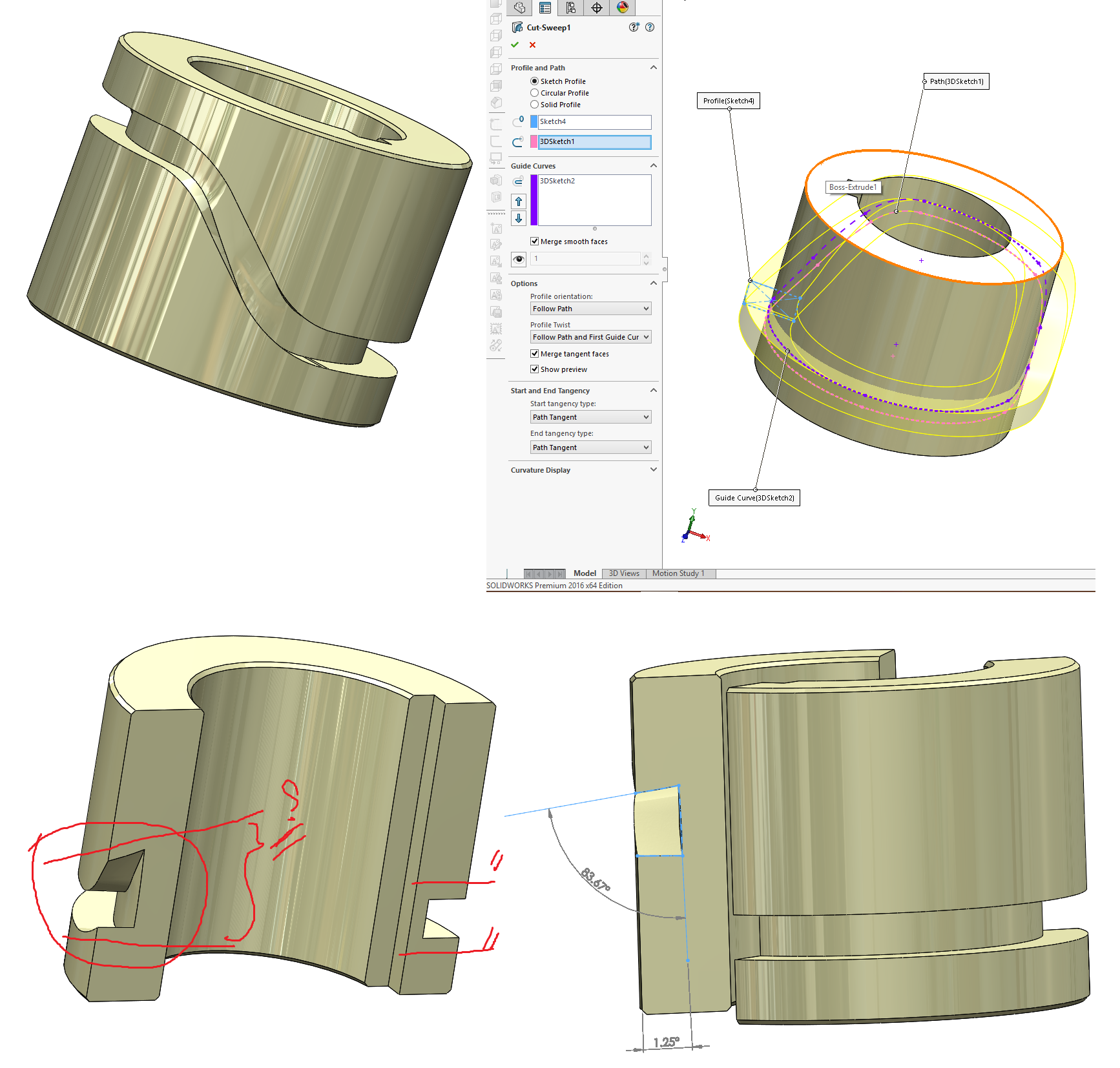

Not Parallel Surface with Swept Cut Hassan Bankey 3 Dec, 2017 09:24 AM When I Use Swept Cut to make this part as drawing attached I get not parallel surface How I Can Fix it Please A2.png Cam 100mm.SLDPRT 2 Answers Adi DRPAX Pandzic Answered on 3 Dec, 2017 09:58 AM Check "Profile twist" Mostafa Shehata Answered on 3 Dec, 2017 01:22 PM Your section is not prependicular to the swept cut so it wouldn't appear like triangle or parallel surfaces.
