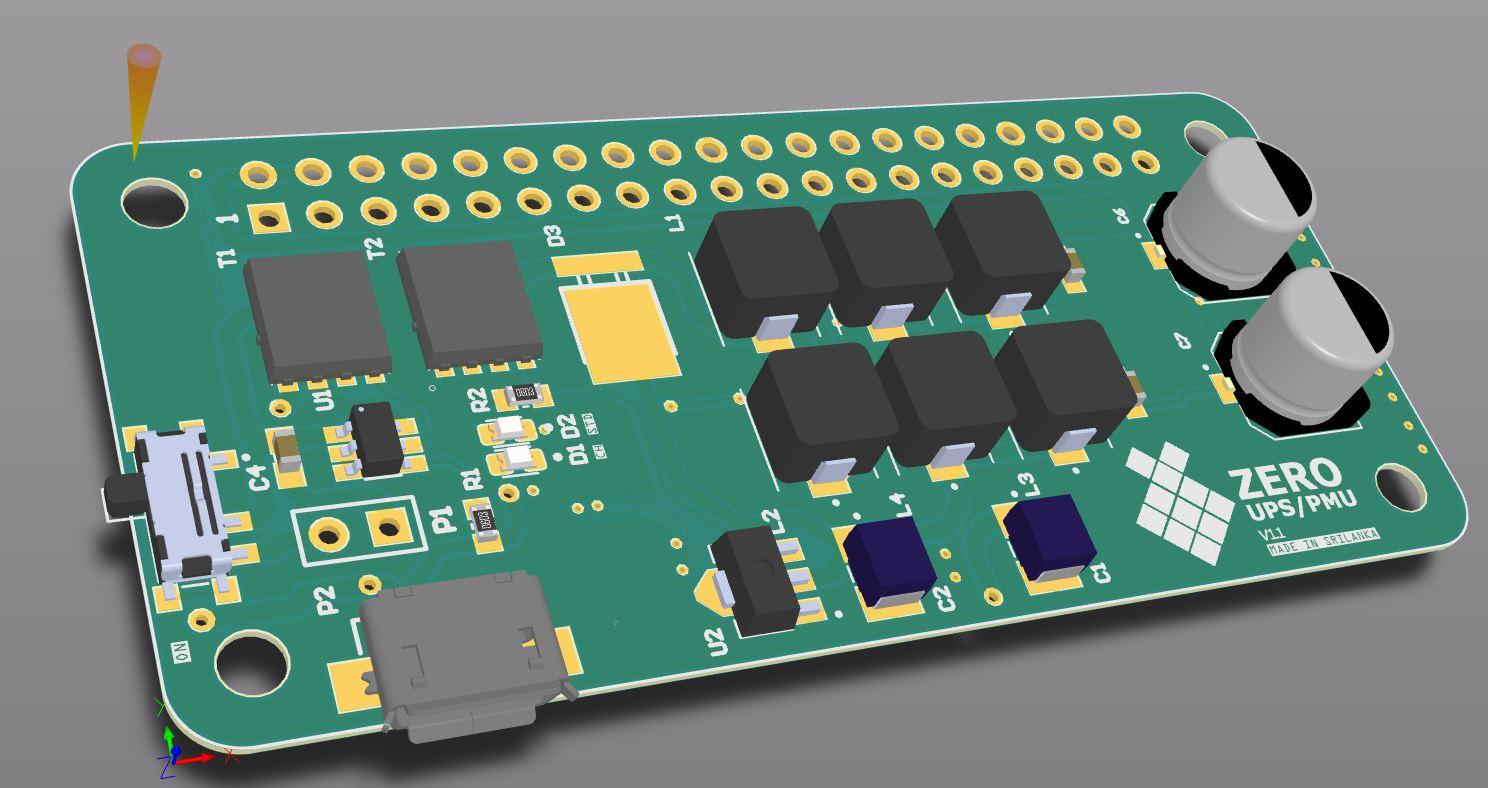

.obj file convert to step or any supporting format is not necessary for my task. because I designed PCB using Altium designer so Altium support obj. if I convert and import SW materiel will Disappear and hall PCB will be one group !
