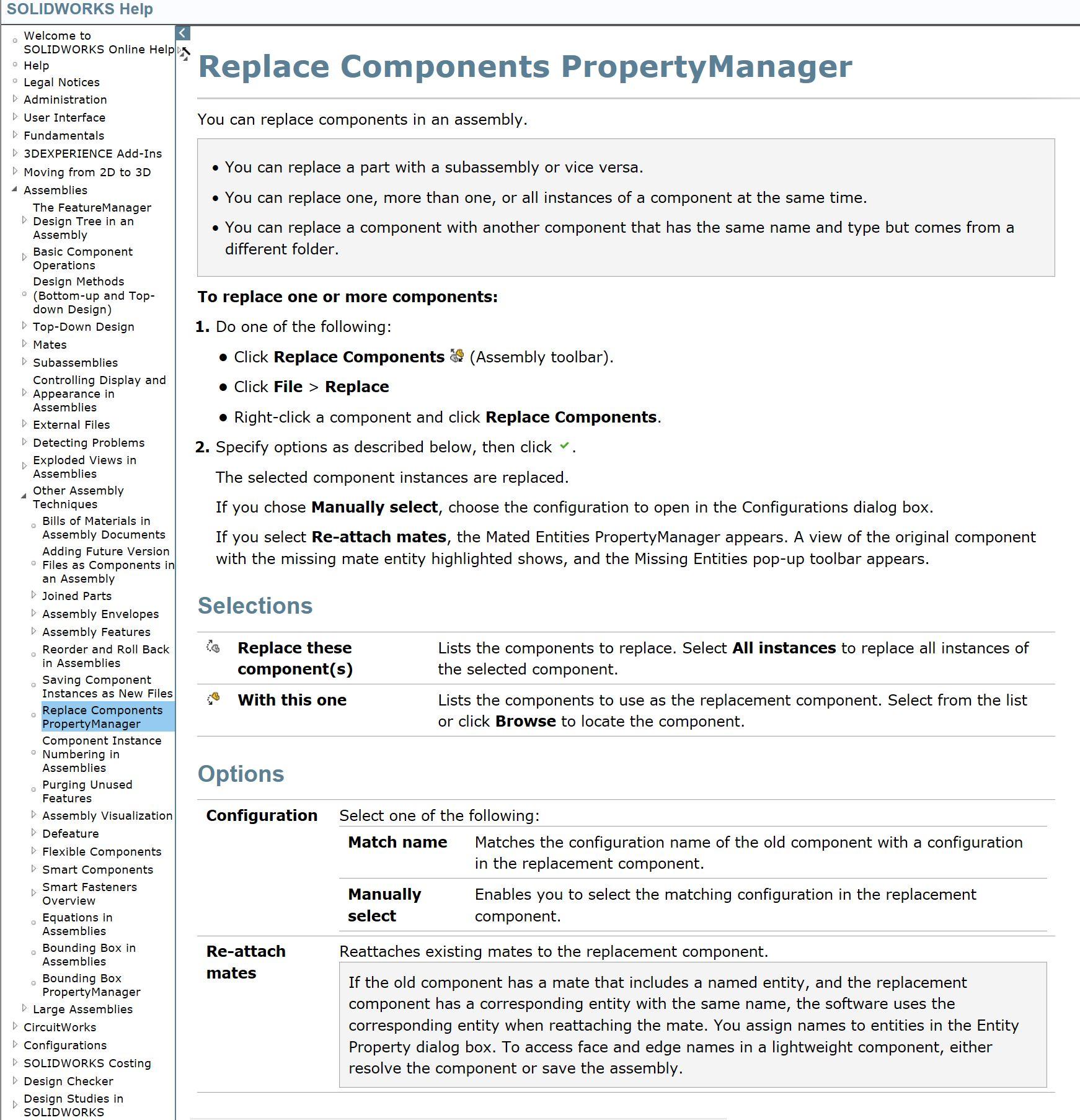

How to replace the components of an assembly.? isuzu sakamoto 10 Nov, 2020 05:01 AM How do I replace a part. 1 Answer Zulfiqar Islam Answered on 10 Nov, 2020 07:41 AM Not sure which 3D CAD is referred but assuming it is a Solidworks case . Please see the attached screenshot from SW help. You will need to add the icon for "Replace Components" in the toolbar using customize toolbar SW HELP part replacement.JPG
