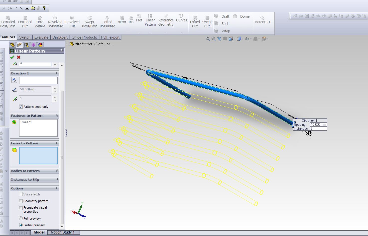

I am creating a linear pattern.
It previews but when ticked off its not visible and all i see is my part. any ideas why??
9 Answers
Robert, you can't pattern a feature if it isn't going to be one body, you have to use pattern bodies ...
Anyway, pattern bodies rebuilds a lot faster than pattern feature in most cases ...

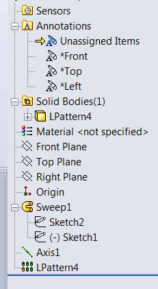

Try combining the body, and don't use partial preview, it sometimes malfunctions and almost never shows a truly "partial view" Can you add a picture of the "techtree" as well?
Yeah, when i press full preview it doesnt show the pattern and i don't know way. This is a basic feature that i have used hundreds of times before :/
Can you add the feature tree picture as well :) ?
I've found that adding axis always causes errors in some way - define the direction of the pattern via a sketch. In my experience it works better.
Hmm thats weird. it still failed if i selected the feature to pattern.
managed to get it to work by selecting the body... Weird.
I'm sure it did :)
Your welcome on the sketch tip :)
w.wolf is correct about bodies
Features (Holes, Faces, Bodies) can be patterened just have to match selection with type
