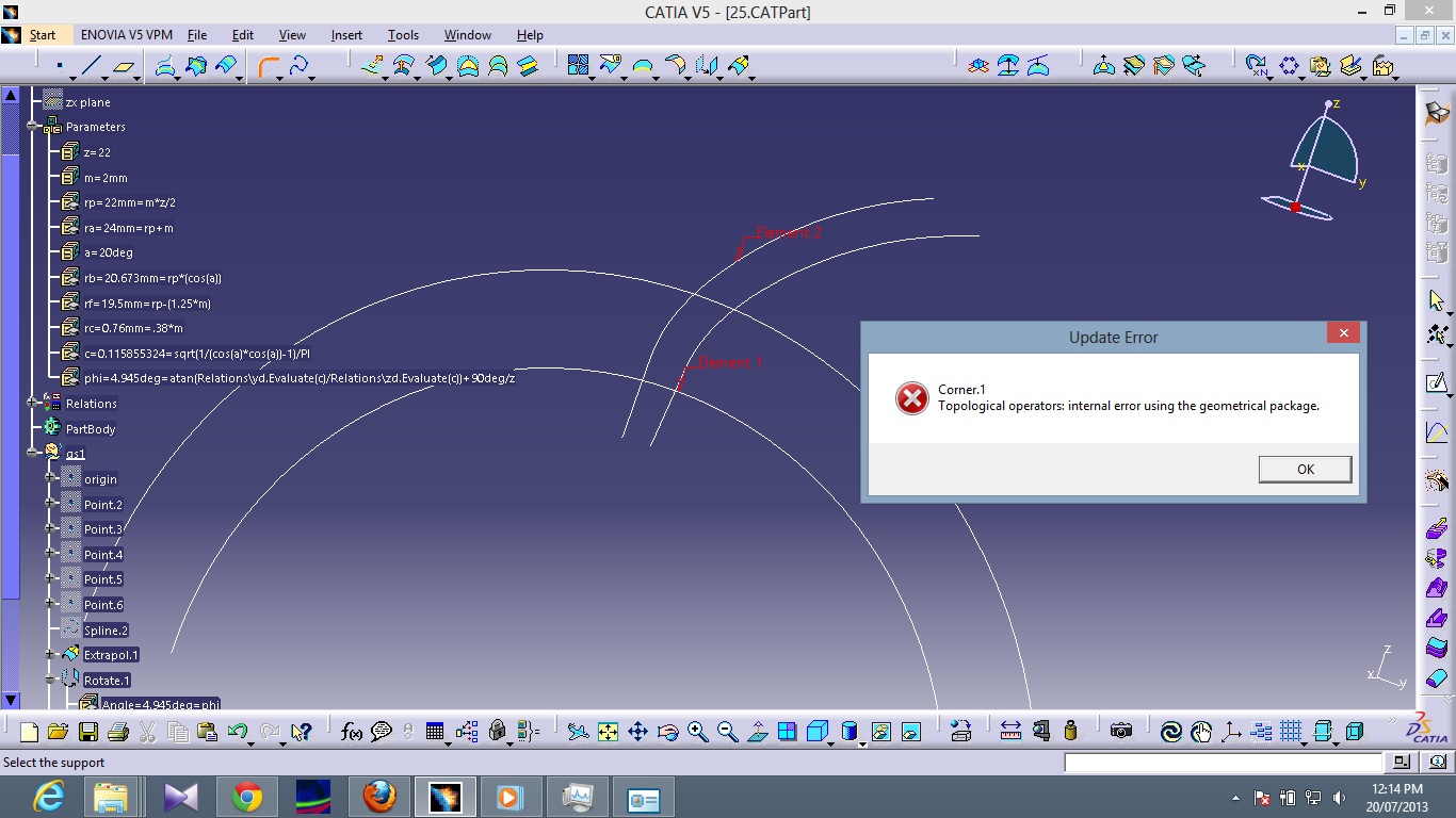

Please explain what this error message means.
I am trying to make a parametric gear and stuck at this particular error message.
2 Answers
maybe those two lines that you selected, do not intersect, and therefore corner can not be done..... very interesting....
Topological error in Catia is an indication that you are doing something wrong at small level.It means either you have selected the wrong command like in sweep command for wrong operation or there is a gap that is beyond tolerance of Catia, or intersection is not there and you are thinking its there.
