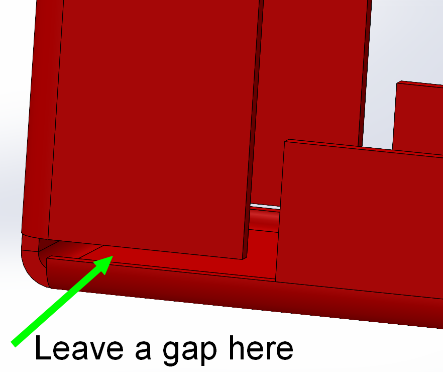

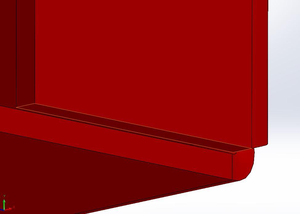

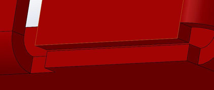

What Does this message means " the part intersects itself after bend operation"? Lina AL-Faouri/CSWP/CSWP-SM 21 Nov, 2021 11:35 AM When i execute the edge flange command i get this message " the part intersects itself after bend operation" does anyone know how can i fix it? Note: SLDPRT is attached Sup2.SLDPRT Accepted answer FredSWUG Answered on 21 Nov, 2021 04:35 PM See attached image Untitled 1.png 2 Other answers Gints Answered on 27 Nov, 2021 12:25 PM this is how I would manufacture this part, closed corner, with 0.1mm ish gap between corners, and then weld up corners. corner.JPG Sup2 updated.STEP Gints Answered on 21 Nov, 2021 07:46 PM See the previous comment that i left under FredSWUG comment try doing corners like this with closed corner feature closed corner feature.JPG
