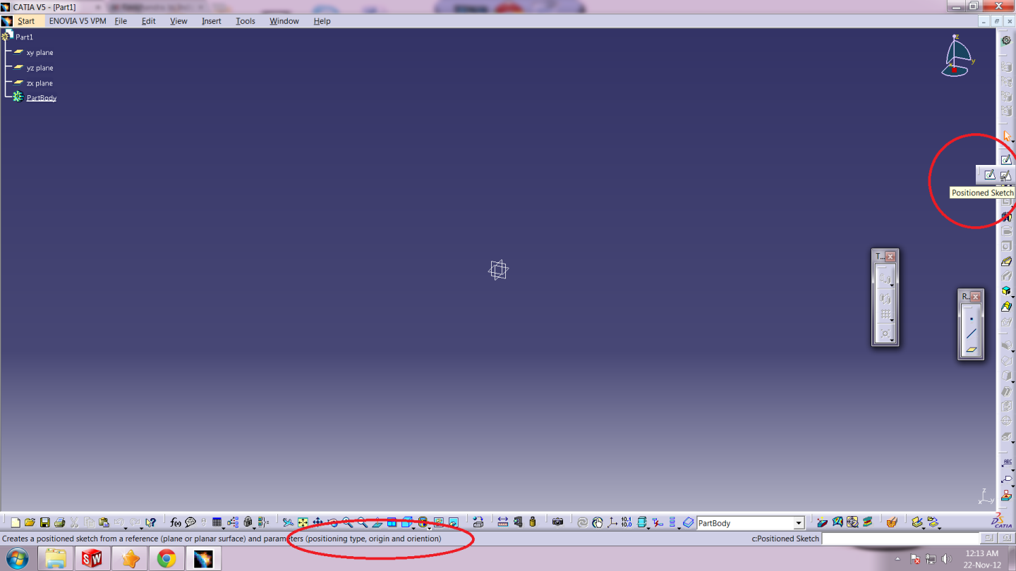

Positioned sketch
Is there a way that "Positioned sketch" feature, like the one found in catia can be done in Solidworks?
I want to control the orientation of a sketch in a plane.

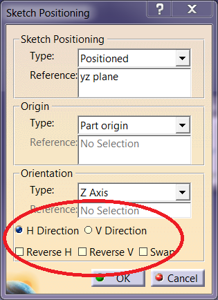

jinx, moving a sketch can be done with derived sketch or copying sketch or convert entities (some cases). But I want to control the orientation of a sketch while drawing it....
I do this in Catia by playing around with H and V.... Can it be done in SW?
