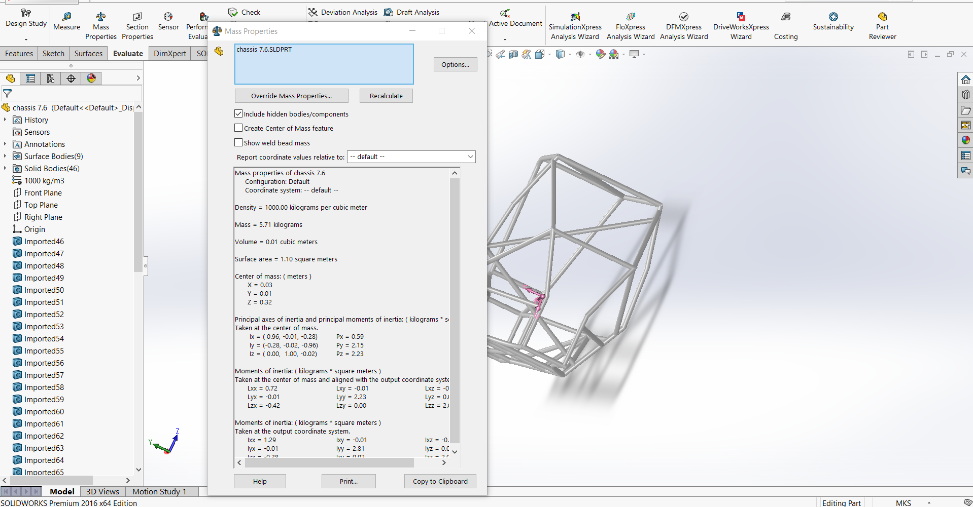

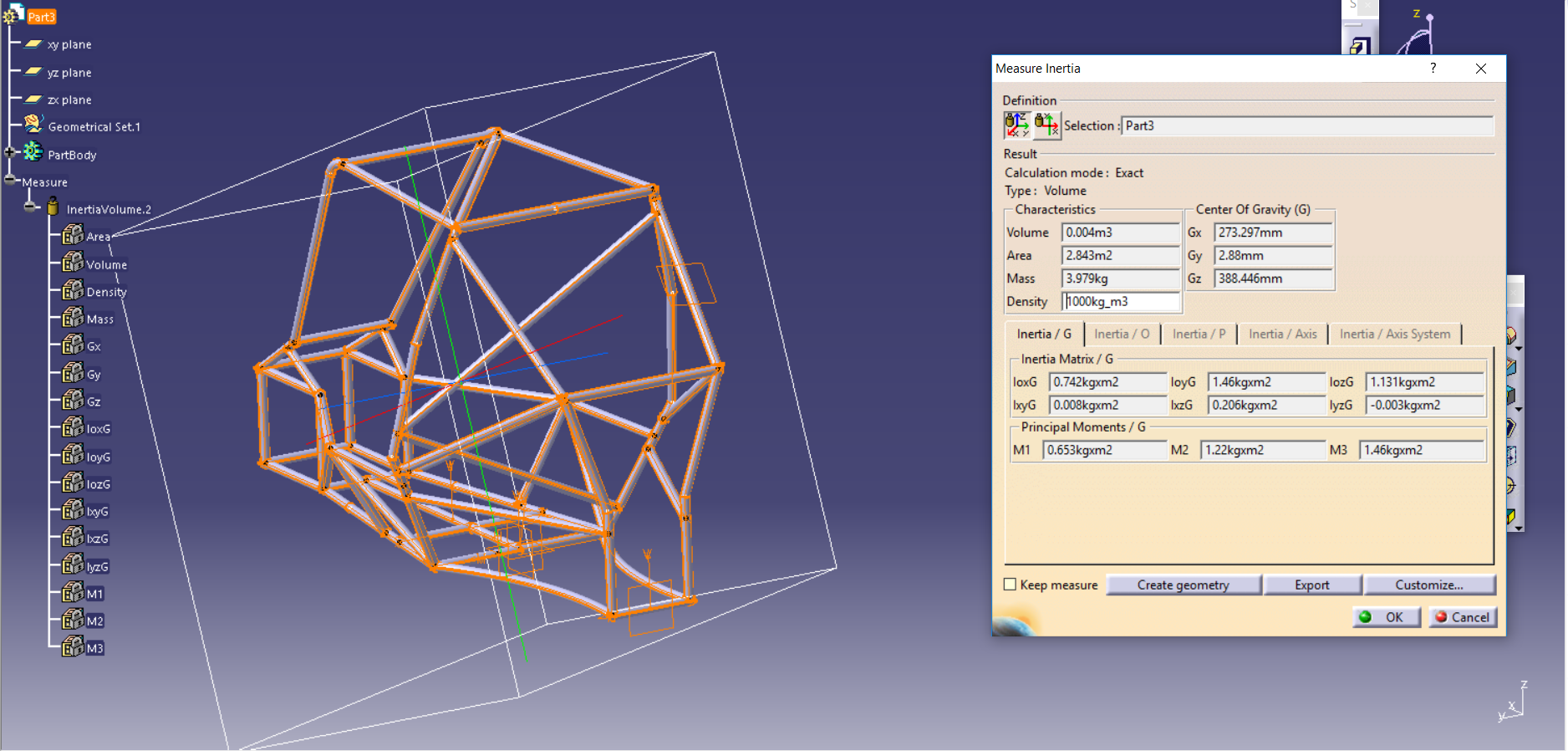

i want to open it in solidworks... when i convert it in iges or stp and open again in catia or solidworks, its mass properties changes... like for same density it was 31 kg before and then when i apply material in solidworks for same density its 44 kgs. why this is happening and solution plz..

When you save it as igs or step, you actually don't save materials or colors. To be sure of density make your own material on both catia and in solidworks. Also it should be noted that the step files on catia will have density of water (1000 kg/m3) unless you apply material to it. You can export color when you save as step but not sure of material. For exporting color with model as step, watch this video https://www.youtube.com/watch?v=QbPe8AMfYjs .

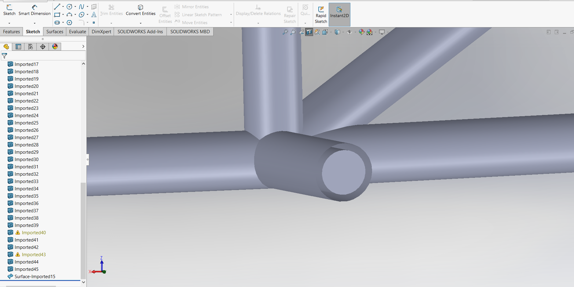

i m attaching screenshots, plz have a look.

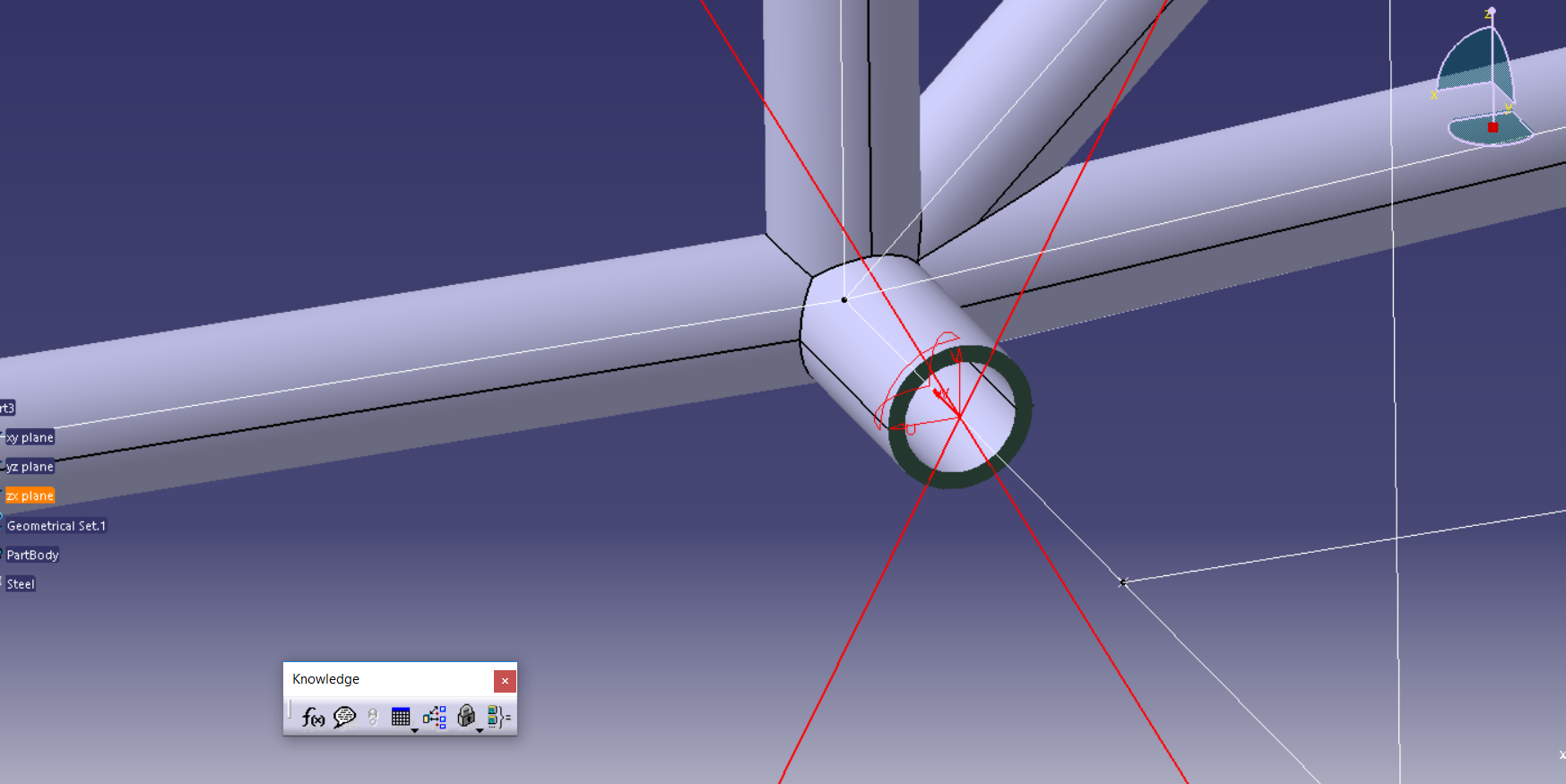

other 2 pics are of same rod using sectioned view, one in catia(orignal) and in solidworks(opened by converting to stp).
why this is happening??
