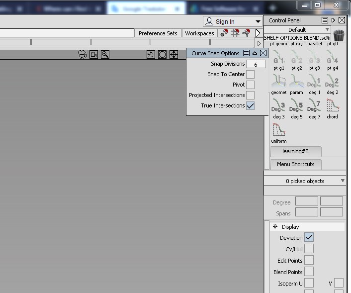

you shouold check your snaps next to the history button probably they are all on

hmm sorry for late reply. There are one possibility too. Alias using mouse buttons as x,y,z directions. Such as using middle mouse button will only let u draw straight line in y and right one will force you z direction. I really cant think anything else
