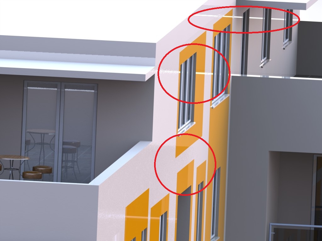

How to COMPLETELY remove any and all reflections from appearance added to part?

you can see in the attached picture that i still have reflection.

i never succeeded to remove reflections on that building by setting scene and face reflections to 0.
but i made it by instead of gray color i put gray texture on that face/extrude
