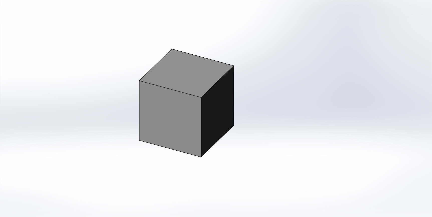

I have attached a .jpeg of a cube shown in an isometric view. The right side face is darkened. How do I make the model solid color with no shading?

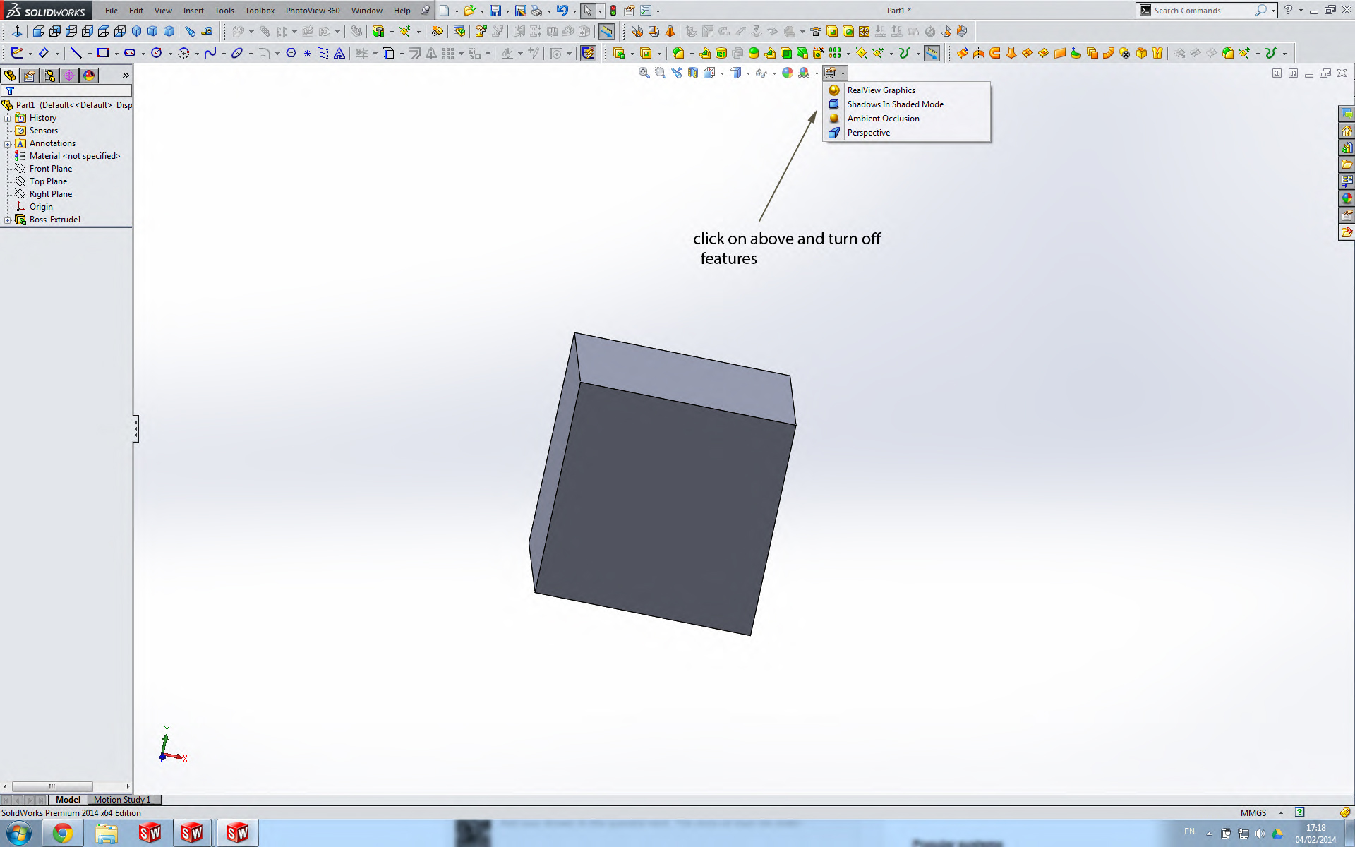

    turn off view options see attached
