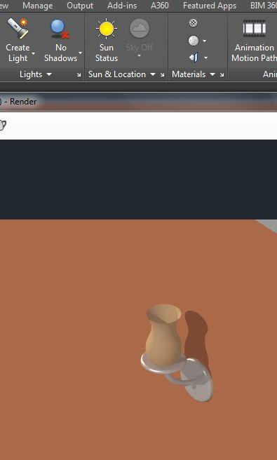

Shadows are too dark in rendering
When I render my model in AutoCAD 2017, the shadows are getting too dark even at the highest quality rendering. When I put off the shadows, they still come. What should I do. I have also attached a file which shows the shadows even when shadows are off.
2 Answers
Hello Ibrahim, from my experience with rendering images in Blender I suspect the light source may be too powerful or direct. As suggested in the link provided by Danny you may be able to add or adjust a background image that allows light to reach the object from multiple directions, that will soften the shadows. Alternatively, you may be able to add additional surface light sources or reduce the intensity of the primary light source.
