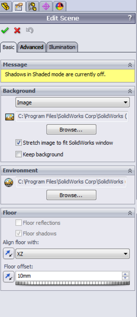

I am currently facing a problem that whenever I render my design, some part goes under the floor plane and cut the edges. Is there any solutions ? (Problem picture is attached)

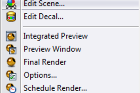

You need to change the floor offset.
