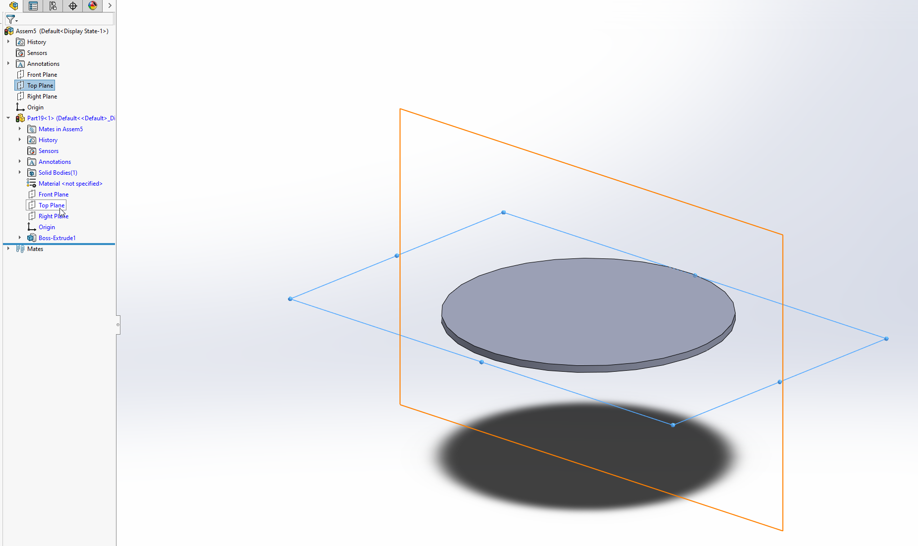

I am trying to insert a part by making a new part in an assembly and I notice that the default planes from my assembly and the planes from the new part I am creating don't match. Can both sets of planes be uniform?
please look at my screenshot here.
2 Answer
In an assembly, if you created the parts in a multi-body part environment then often the only constraints you’ll need are flush constrains to each of the three main sketch planes. X flush constrained to X. Y flush constrained to Y. Etc.
However if you create the parts individually in their own individual part files then flush constraints to the main planes usually won’t work. The main reason being the parts are usually created directly on their main XYZ axis and not necessarily in the same orientation. In this case, in the assembly, they will require other diverse constraints relative to other parts and not the main planes. Furthermore, the relative positioning and orientation of the part planes and the assembly planes is usually irrelevant in this case.
In your case, the part was inserted and then rotated relative to the main planes. How it got in this orientation is somewhat irrelevant. How you reorient that part relative to the main planes is entirely up to you and should be done cognizant to the original method and environment of the part file as described above. Never depend upon a part file just automatically being in the correct orientation and location. It probably won’t be and subsequently can be easily moved and rotated. Parts should always be constrained in the proper location and orientation.

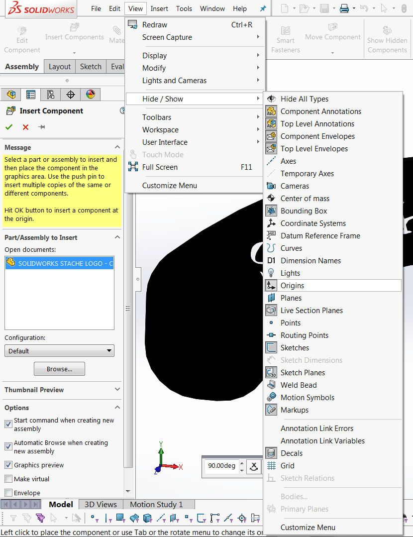

This might help, Right click your part and hit "FLOAT"
Then mate the planes you want coincident.
Also you can turn on your Origin when inserting the first part & put your cursor on the XYZ co-ordinate plane and a little icon will show when it snaps the component coordinate system to the ASM coordinate system
https://grabcad.com/tutorials/how-to-change-your-plane-of-refernece-after-assembly-is-made-is-is-possible
