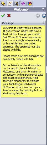

As far as I know, SolidWorks Flow Simulation (the full package not FloXpress) does not cater for moving parts.
