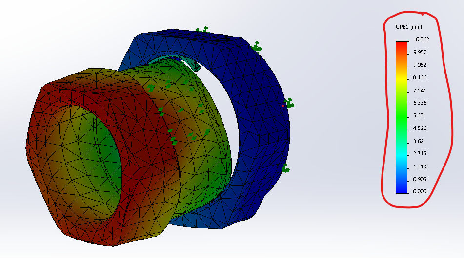

I have a question about plots in SolidWorks Simulation. In the attachment you will find a picture of my results. In my last company the legend used to have an arrow with which you could move the plot results, e.g. lets say you had ten steps, where the first step was the beginning of the simulation and tenth step was the end, you were able to see the steps in between (as you can see them when you play an animation). But now I can't do that anymore. I tried to Google it but couldn't find anything.
Does anywhone know where can I activate that again?

Possibly what you mention happened with non-linear simulations, which save steps of the solution. Static simulations are generally obtained in a single step. However, you can use the "Animate" to view a deformation or stress sequence from its null values to its final values (deciding how many steps you want to do it in).
