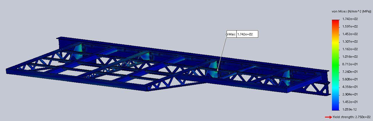

I have one console type balcony structure fixed to existing I beam with M16 Bolts from Wurth Grade 8.8 Din 933 standard.
Material is MS S275JR steel
Solidworks 2019 only.
I get my results but I don't have enough confidence in it.
If someone can check and show me his results with my settings for mesh, it would be appreciated.
All files are available in the download link.https://we.tl/t-RWO5jTiD1q
Also, if anyone noticed an error in my settings, please let me know.
