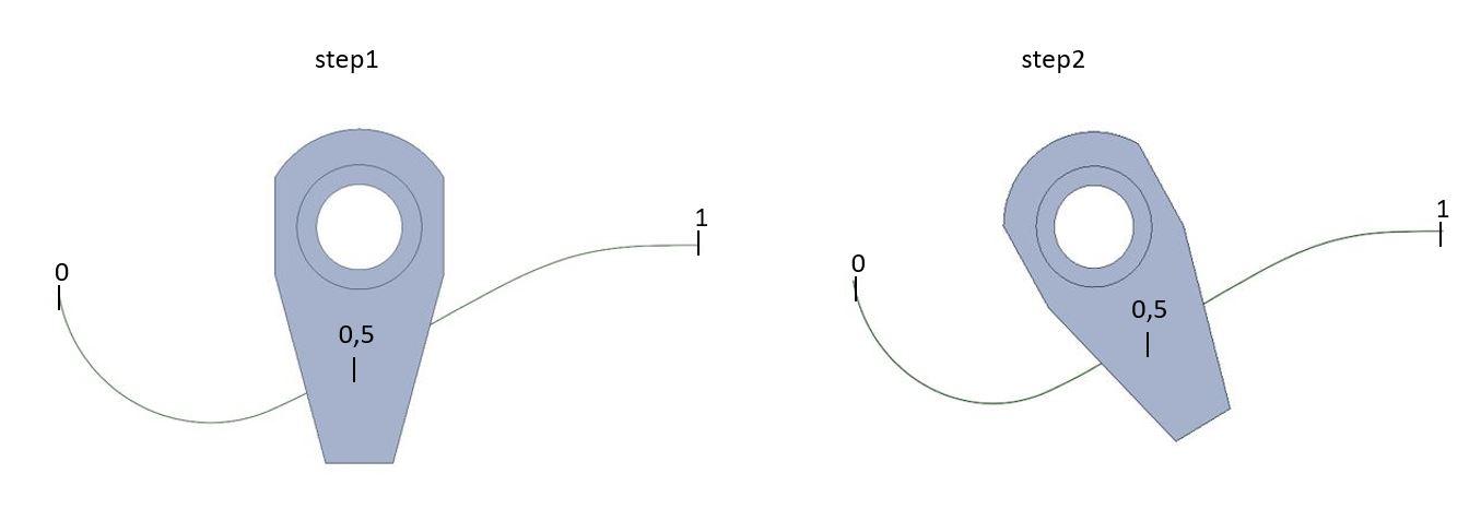

Hello guys,
In the 1st step move the component along the curve and then in the 2nd step rotate the component orthogonal to the curve. I have the problem with the 2nd step. Depending on the position of the curve my Part get a different rotation angle. Is there a function in Spaceclaim that can automatically return the angle of twist orthogonal to the curve. So i want to automate it with python script .
I hope you understand what I mean.
