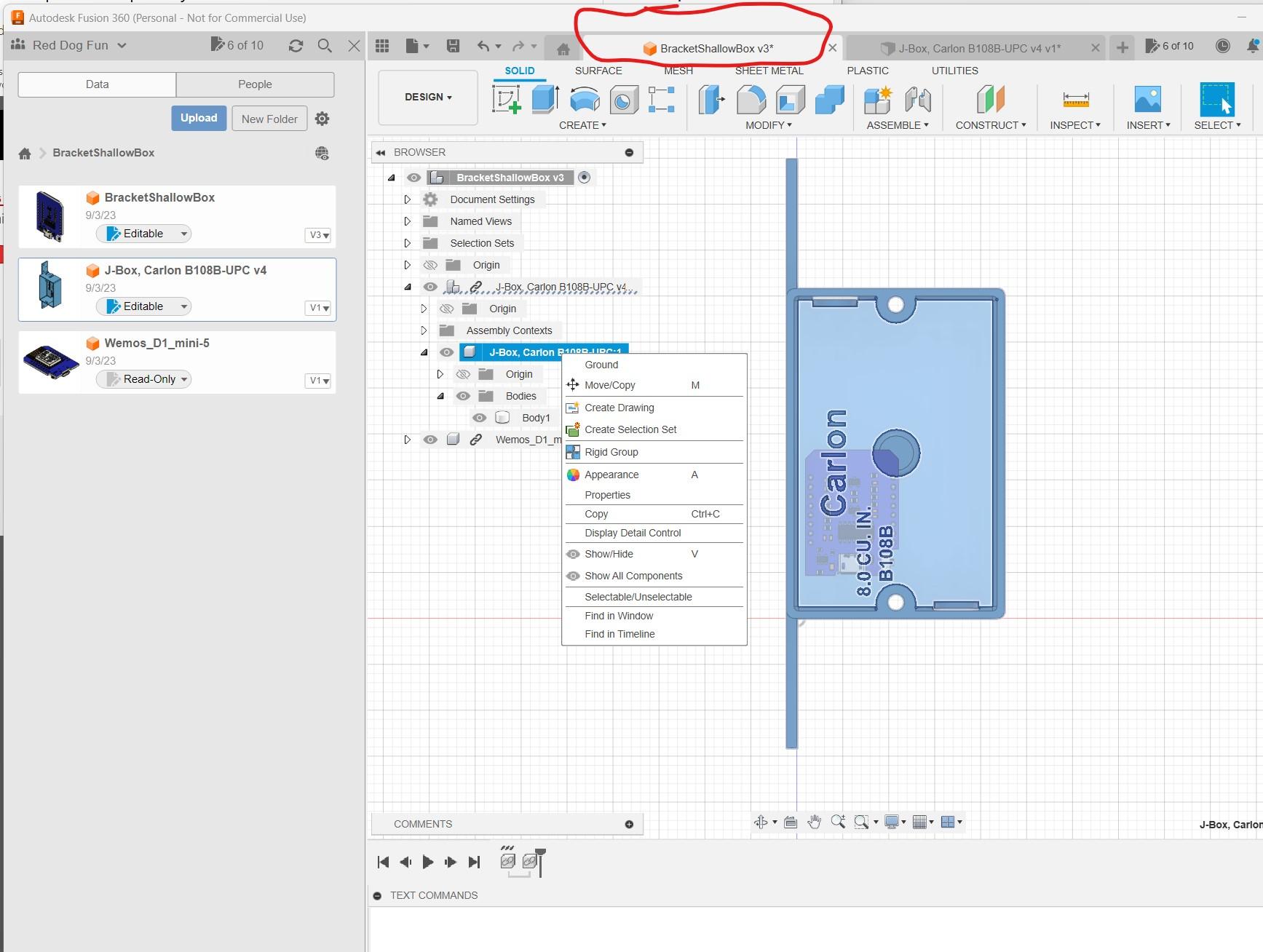

I'm using Fusion 360 to import step file “J-Box, Carlon B108B-UPC v4.step” and having a problem of changing the transparent of the object. The transparent control is missing in Fusion 360 for the imported object. From what I have found so far, this is a problem with Fusion 360 and also found solutions, sketches codes, that don't seem to work for this step file.
Hoping some knows how the make Fusion 360 be able to change the transparency of the object or a way to modify the step file to allow transparency control.
