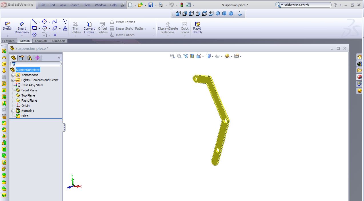

Hello,
I accidentally clicked on a button that turned my Solidworks part transparent (yellow) and I cant figure out how to change it back. Does anyone know what button I accidentally pressed and how I can get it back to being opaque. I am using Solidworks 2008

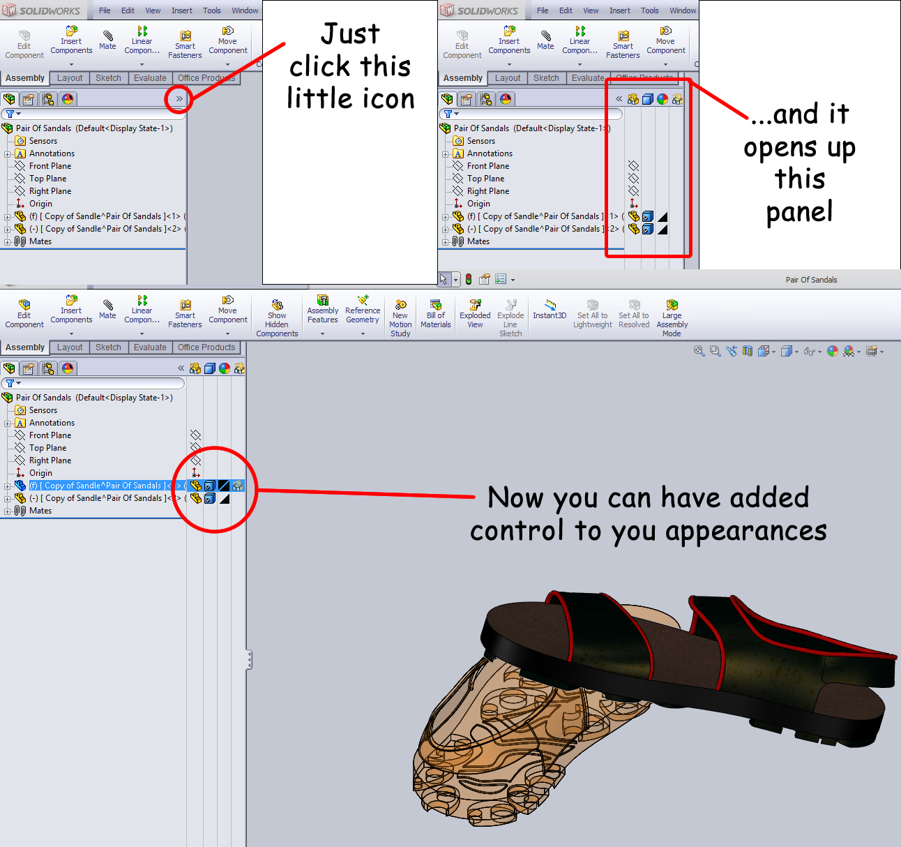

    I think this will help you out ;)
  • Hans de Ridder
    Hans de Ridder over 4 years ago
    Click in the tree the main that needs to be showed, than in "Show with dependents..
    All hidden items will appear
