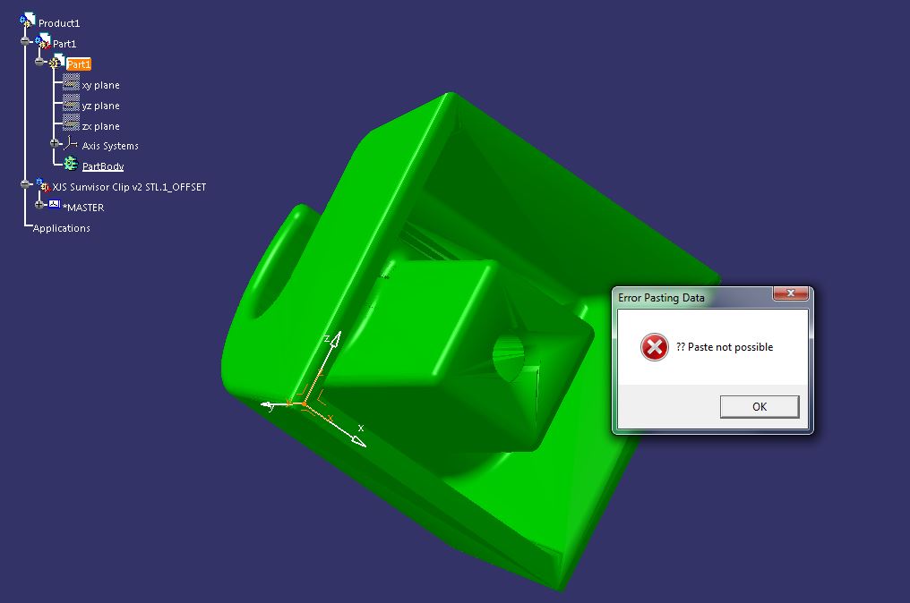

After conversion from .stl file to .model to use it in CATIA V5, i can't copy paste the content of the .model in a new .CATPart.
The following error appears : "?? Paste not possible"
Could you help me find out what is the problem ?

By the way, here is the method I used to convert from .stl to .model.
1) create a product in catia
2) go to DMU optimizer
3) insert new component (.stl file)
4) click offset button
5) register the file with 0mm offset as a .model file
best regards
